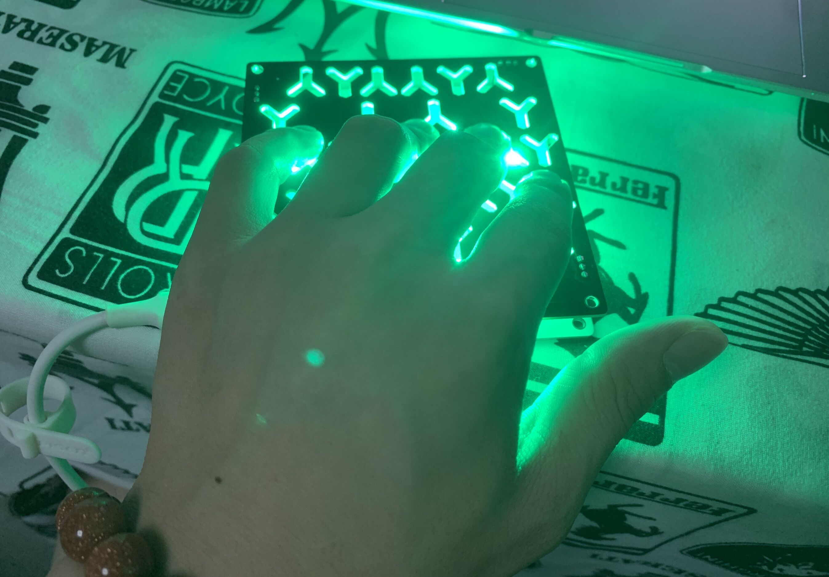

The project mainly uses the TTP223 touch chip. When the chip's induction coil senses an object, the chip's 3rd pin will output a signal to control the conduction of the MOS tube, thereby turning on the LED light. The idea of ​​this project can make a touch desktop, but it requires multiple boards to be spliced ​​together, or a large board to be produced. This touch desktop uses two layers of boards. I use an aluminum substrate for the bottom layer to facilitate the heat dissipation of the LED light. The shape of the top layer can also be designed by yourself. The top and bottom plate files are all here, but I don't know how to layout this.
