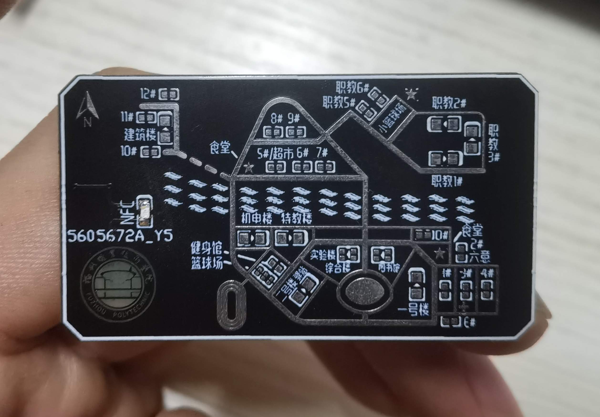

Fuzhou Vocational and Technical College miniNFC campus card
The size of the card is 2.8*5cm
. There is a 0603 LED on the front. It can light up when you swipe the card when it is attached. It can also work normally
when you attach the 3*5mm CUID chip. You can use your mobile phone to simulate a campus card. Tips: The UID chip can only be read and written with a card reader.
