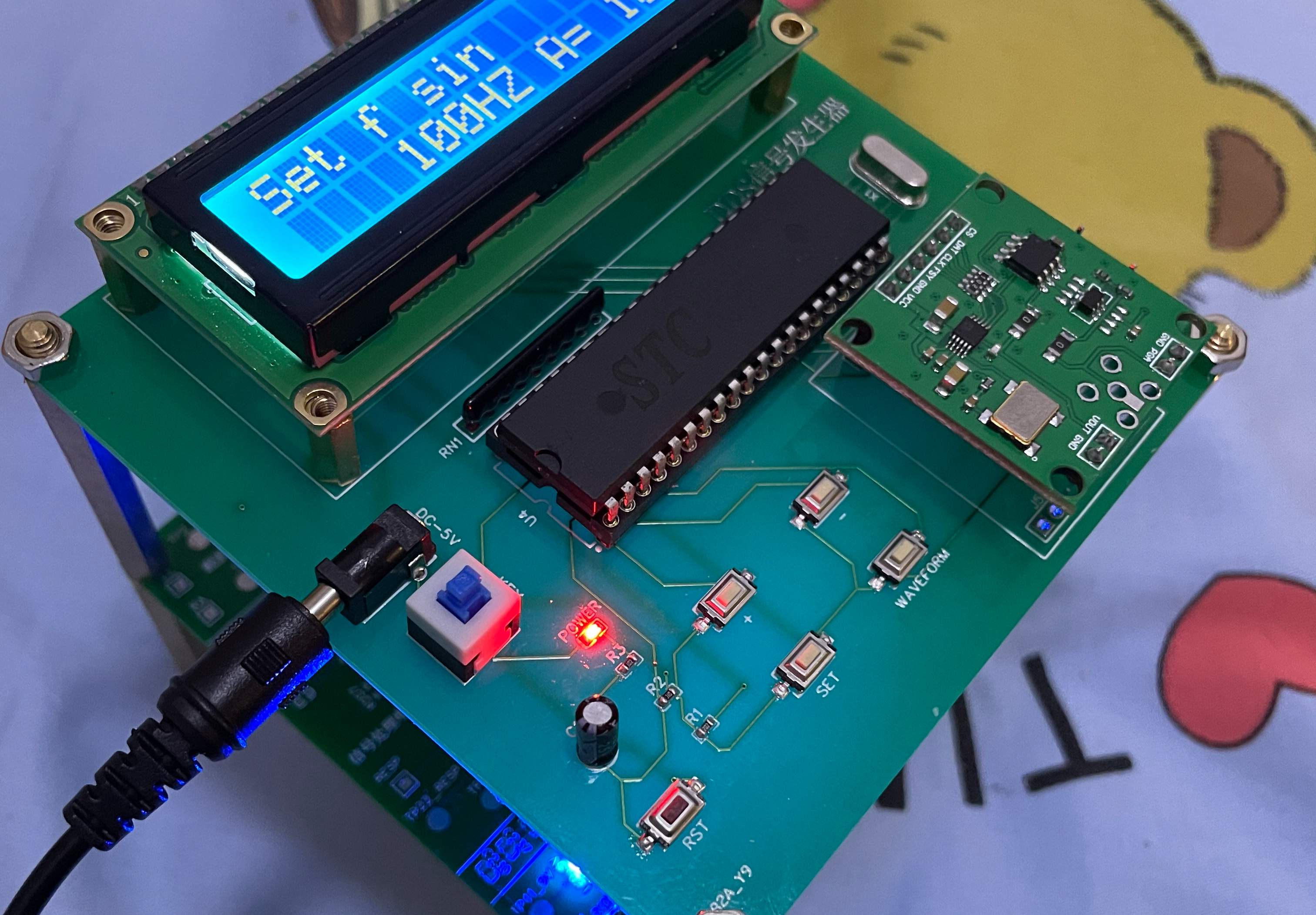

This project implements the following functions:
1. Output sine wave, square wave, triangle wave adjusted by buttons
2. Frequency 100Hz-1MHz adjustable
3. The amplitude is adjustable from 0-5V (actually it cannot reach 0V, but is close to 0)
4. Frequency and amplitude are step-adjustable (step 1-10000), with reset button
Details: DC head 5V power supply, LCD1602 and the studs of the entire board are M3 models
Key Description:
+/-: plus/minus button, long press
SET: Setting button, f is to set the frequency, A is to set the amplitude, B is to set the step
WaveForm: waveform setting button
Instructions for use: Burn the hex file to the microcontroller
This project is a high-frequency signal generation module for a respiratory signal measurement circuit, and that module requires a 10*10cm PCB board, so this PCB board has not been compressed. If there are any deficiencies, please feel free to raise them.
You are also welcome to follow me and I will continue to share in the future.
--------------------------------Dividing line---------------- ----------------
Since the amplification factor of the AD9833 module is 5 times, sometimes the amplitude of the waveform will decrease if the frequency is too high, so I followed the official manual of the module and made a V2.0 version with adjustable amplification factor.
The following functions are added based on the previous version:
1. Add an emitter follower and output it from the PGA1 port to improve the load capacity.
2. Add the manual adjustment magnification function, using a 3296W sliding rheostat (set tone 20KΩ), which can theoretically amplify the original signal 0-20 times and output it from the VOUT1 port
3. Add SMA interface to output PGA signal
4. Add 5V voltage output
