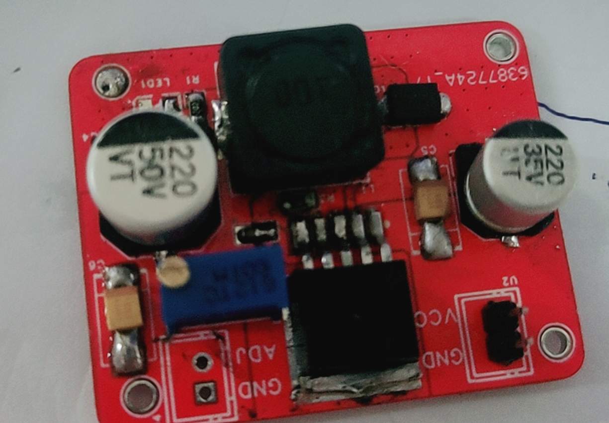

**Physical test**! [19FE43E8278A946BD5923E73EA5F84F4.jpg] Supply 5v
! [QQ picture 20230714095012.jpg] Adjust the potentiometer
! [5327.jpg] ! [4095124.jpg] The maximum is close to the power supply voltage here.
12v repeated test
![0714095233.jpg]
