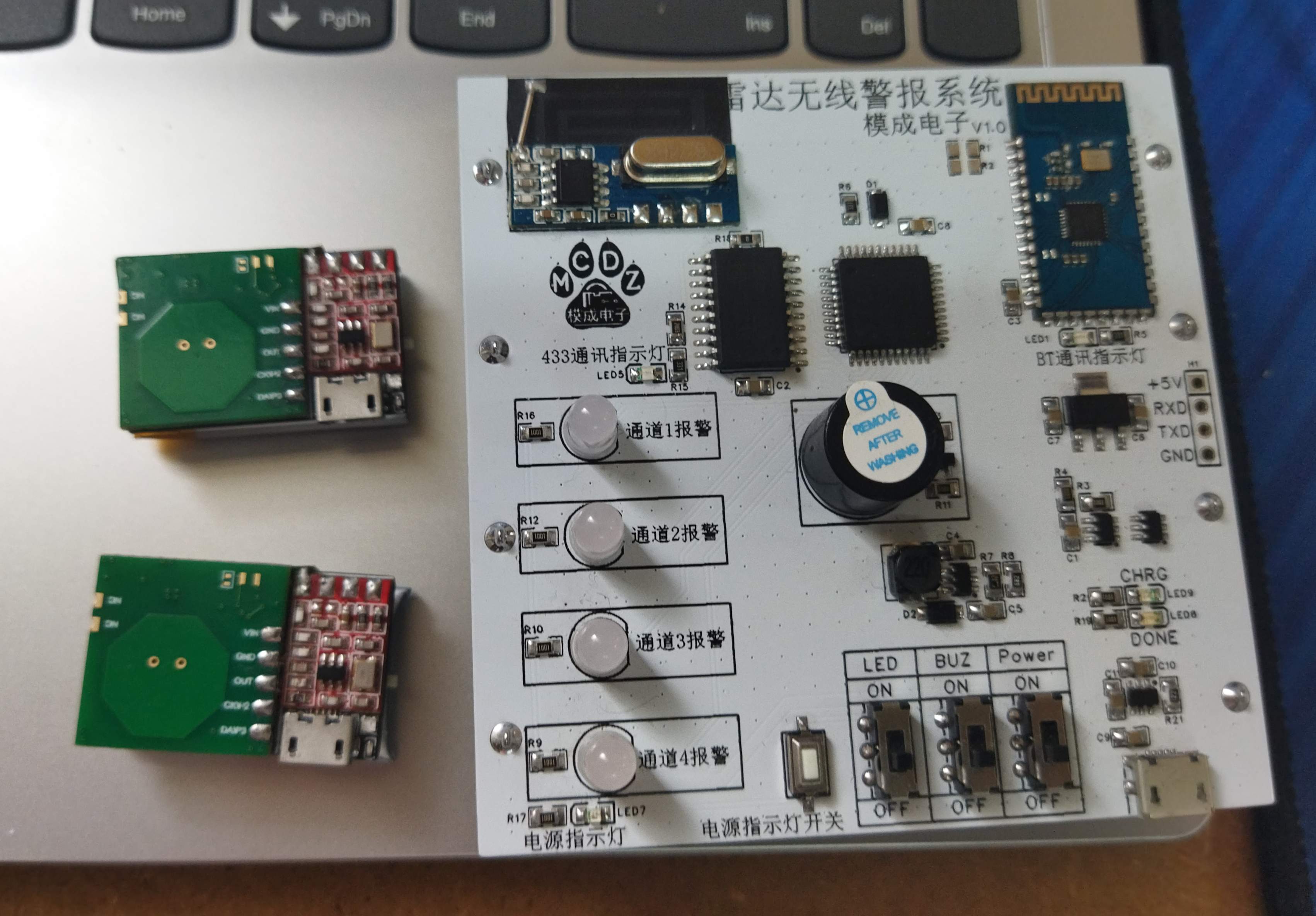

I helped a classmate to do a project. The classmate was playing with his mobile phone in the dormitory at night and did not know when the dormitory manager would come to check the room. In order to solve this problem, I made a prompt system and designed this. The sensor was installed in the corridor, facing the corridor passage.
If someone passes in front of the sensor, the millimeter wave radar signal is sent through the microcontroller code 433. There are a total of 4 channels transmitted to the receiver, which can be installed at 4 different locations in a corridor or monitor 4 corridor channels at the same time.
It can also be used to detect whether there are people in the environment, and can also be used as a doorbell.

Millimeter wave radar detects whether there is someone in the channel. If so, the millimeter wave radar sends a signal through the single chip encoding 433 module. It is transmitted to the receiver, and
the receiver 433 hardware decodes it and sends it to the microcontroller. The microcontroller processes the sound and light display of the alarm information and sends data packets to the host computer device through Bluetooth.

millimeter wave radars have been measured to penetrate gypsum board walls and are effective after penetration The detection distance is 2 meters, and the effective detection distance in the open field is 5 meters. In the test video, millimeter wave radar sensor modules are installed in classrooms on both sides of the corridor.
