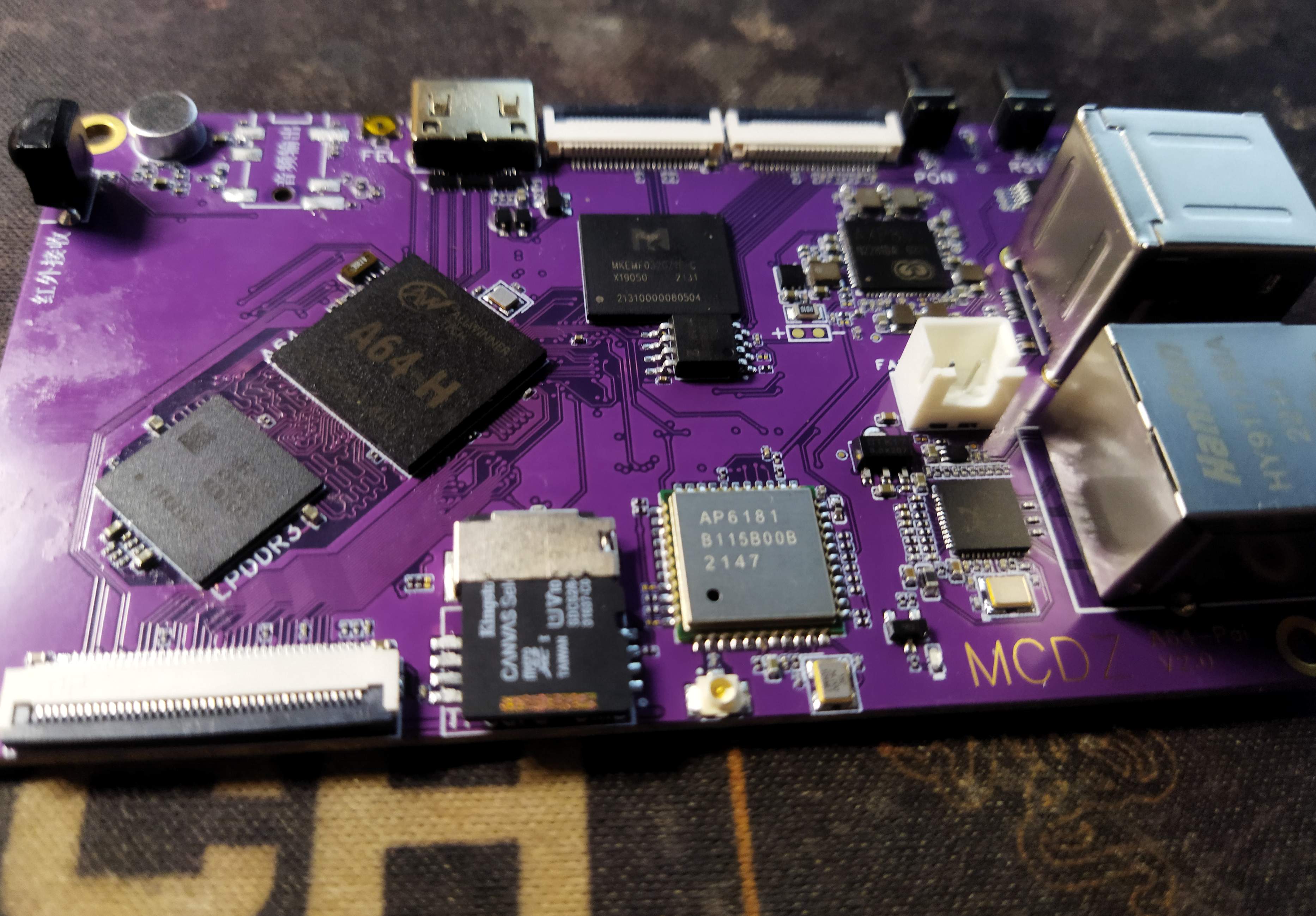

Allwinner A64 development board, currently in the testing and update stage, configuration: main control: A64-H, 2GB LPDDR3 memory, onboard 32G EMMC and SMD8GTF cards, equipped with TF card slot, output: two USB2.0 interfaces, onboard 340 serial port , 100M wired network card, WIFIBT module, video: MINIHDMI, LCD screen, analog audio output. Thanks to @wanjie for providing the driver file. The test passed with the Allwinner test software, but I don’t know how to write the software and the test frequency cannot be increased. It may be because the soldering is not done properly. After a while, re-open the steel mesh for welding and test again.
