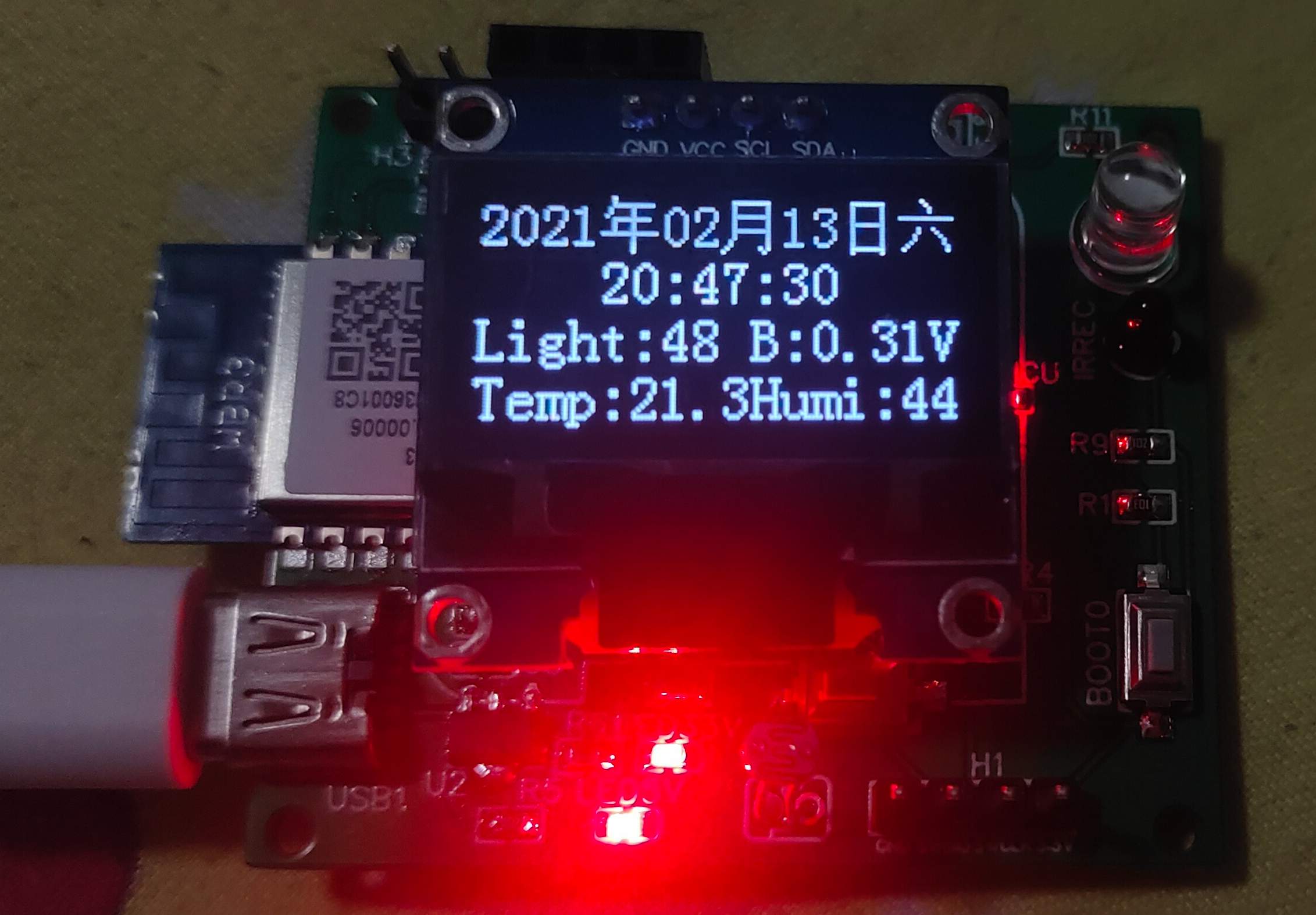

You can connect to WIFI and upload temperature, humidity and brightness information to the Tuya IoT platform. The microcontroller uses the domestic CKS 32F031K6T6 , which is low-priced and has many pins. It is fully compatible with the same model of ST microcontroller. The temperature and humidity sensor uses SHT30 , and the brightness information is collected through a photoresistor. The infrared sensor can be matched with the OLED screen for low power consumption management. The OLED will only display when someone walks by or waves in front of the module. OLED uses a pin header + female header connection method, which is more convenient for DIY. The battery power supply uses a high-current, low-voltage drop chip. The external lithium battery can be equipped with an integrated charging and discharging module, supporting up to 6V. The lithium battery pack can be placed under the OLED screen. OLED screens can display various information, such as temperature, humidity, brightness, etc.
Instructions for use
After welding and burning are completed, power on, information can be displayed on the OLED, and the network is automatically configured in the Tuya APP. After the network configuration is completed according to the prompts, the values ​​can be viewed in the APP.

  • Most of the patch welding is completed, but the SHT30 is soldered, so let’s debug the OLED and MCU first.
  • Purchased heating table and solder paste on Taobao
2021-02-03
  • Solder paste and heating table arrive for soldering
2021-02-04
  • Debugging code, SHT30 cannot read temperature and humidity
  • The Tuya module keeps sending heartbeats, but the response is invalid.
2021-02-06
  • SHT30 problem solved and can be read normally
  • The Tuya module cannot be initialized due to MCU serial port interference. After the MCU code is cleared, the assistant can be used to debug. Data can be reported using the MCU, but the network cannot be configured.
2021-02-07
  • The reception was interrupted and I forgot to remove the debugging code. The network distribution problem was solved and the project was basically completed.
2021-02-11
  • Added time display and online proofreading time
2021-02-13
  • Added a timer to check the time every ten minutes
  • Optimized OLED display layout
  • Added battery voltage display. The cover picture forgot to multiply the voltage by voltage. The actual program has been changed.
  • Optimize the configuration of DMA and ADC to achieve the fastest update speed, and configure ADC to 12bit
  • Add infrared sensor and automatically switch the screen when your hand brushes it
  • Add a watchdog to prevent the program from getting stuck
Project summary
At present, the code has completed reporting the temperature, humidity, and brightness information. Because there is no lithium battery for the time being, there is no battery information to report. The interface and location have been reserved, and the lithium battery can be reported directly. The OLED library encapsulates some functions. Currently, the values ​​of each sensor are displayed. Users can directly modify the format they want in while(1). An additional set of IIC and serial ports are introduced, which can add other things and facilitate debugging.However, the infrared sensor is a bit insufficient, because the ADC and DMA acquisition and channel switching take too long, so the ADC data refreshes every 0.5 seconds, which does not matter for the photosensitive, but it takes a little longer for the infrared sensor.(There were some configuration problems, which have been overcome). This is my first time making a board and doing a project. I have tried my best. The qaq code is written using STM32Cube IDE. Just open .project. Display time_Kantuwang.jpgCover image V4.0.jpgQQ picture 20210207104808.jpgQQ picture 20210207104725.jpg
