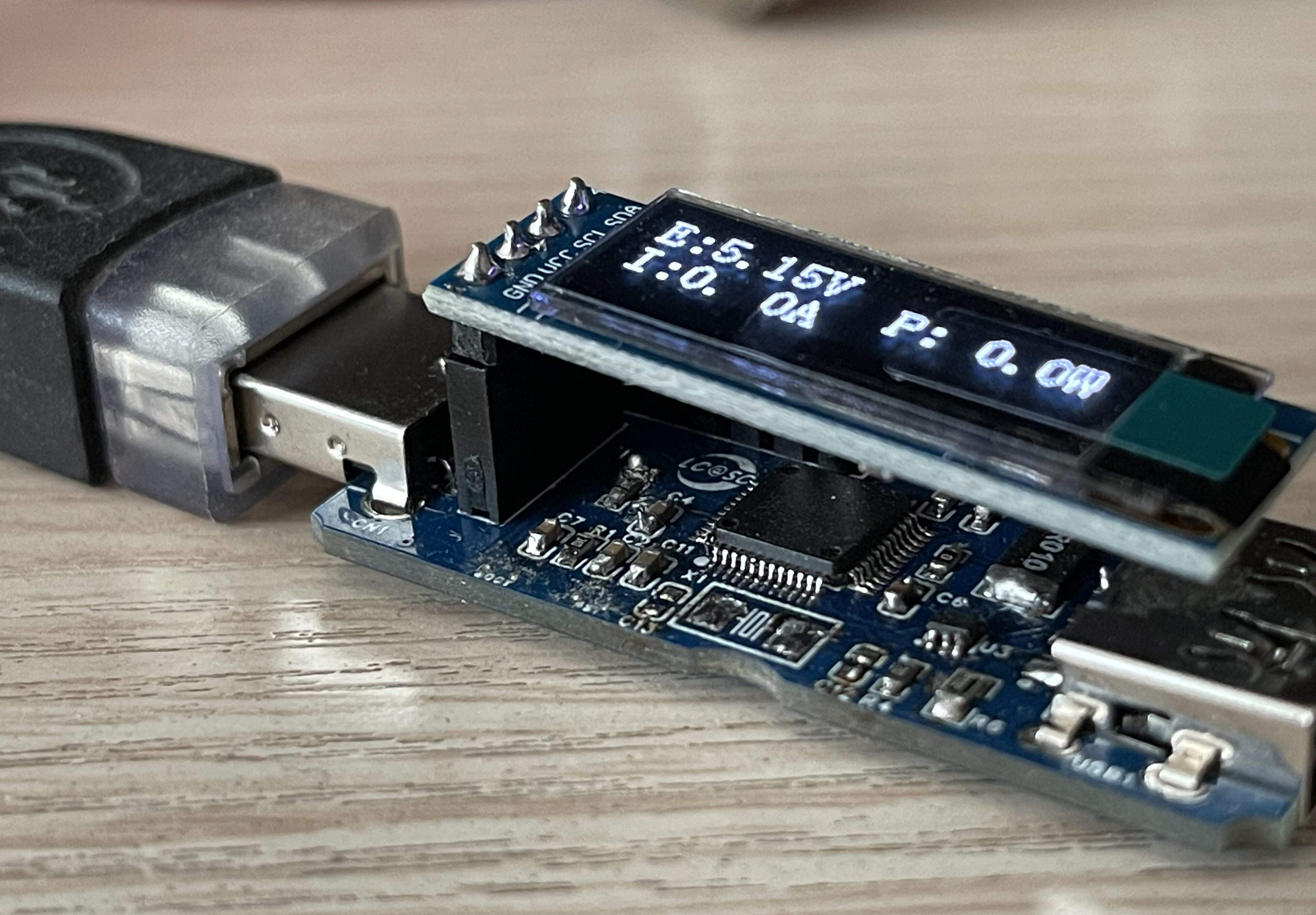

1. Project function introduction:
USB ammeter based on N32G430C8L7+INA199, with an accuracy of 1%. It can detect current, voltage, and power, and display them through 0.91 oled.
2. Project attributes
are not original, and reproduce the official case of the training camp.

4. Hardware
The N32G430C8L7 microcontroller product adopts a high-performance 32-bit ARM Cortex™-M4F core, integrates a floating-point unit (FPU) and digital signal processing (DSP), and supports parallel computing instructions. The maximum operating frequency is 128MHz, with up to 64KB of on-chip encrypted storage Flash, and supports multi-user partition authority management, and supports 16KB of embedded SRAM. It has a built-in internal high-speed AHB bus, two low-speed peripheral clock buses APB and bus matrix, supports 40 reusable I/Os, provides a rich high-performance analog interface, including a 12-bit 4.7Msps ADC, supports 16 external input channels and 3 internal channels, and provides a variety of digital communication interfaces, including 4 U(S)ARTs, 2 I2Cs, 2 SPI/I2S, and 1 CAN 2.0B communication interface. The N32G430C8L7 microcontroller product can work stably in the temperature range of -40°C to +105°C, with a supply voltage of 2.4V to 3.6V, and provides a variety of power consumption modes.
    The chip used in this project is N32G430C8L7.
    When designing the circuit, it should be noted that each power pin of the chip needs to be connected to an additional 100nF external filter capacitor, and the 1st pin of the chip needs to be connected to an additional 4.7uf filter capacitor. The circuit diagram is shown in the figure.
5. The source code of the software part
uses the official case program of the training camp without any changes... The compilation and burning are carried out using Keil5 IDE. It is necessary to add the National Technology N32 chip package in Keil. I use ST-Link for burning.
