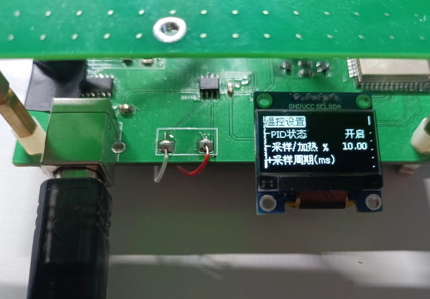

This project was made with reference to the peng-zhihui/OpenHeat project. In order to facilitate welding, the esp32 chip of the original control board was abandoned and replaced with an esp32 module and pin to pin modified board. It has the same operating logic as the original system. Rotate the encoder left and right to select, press to confirm, and long press to return.

Use the on-off switch of a multimeter to measure the connection. If there is no problem, you can connect the uab-c/uab-b interface and burn the program first (16PIN usb-c is not easy to solder.
