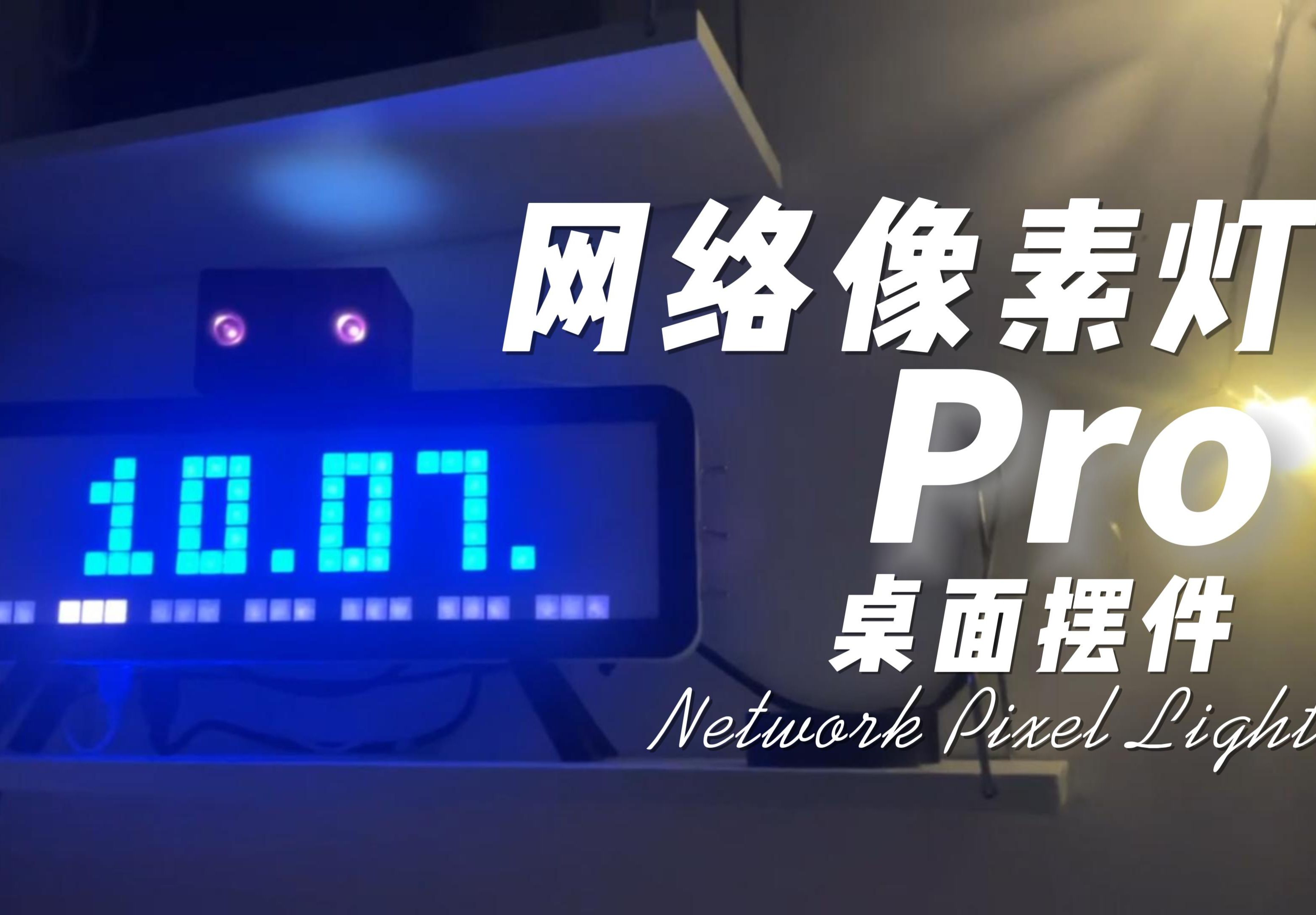

Network Pixel Lamp Pro Version (Charging Expansion Edition) "——- Physical Video
Project Introduction:
This project is combined with the expansion of the awtrix project. The main functions
can be used as a good table decoration
. Pixel game display.
USB charging. Expansion.
Temperature detection.
Bluetooth audio
built-in. The Raspberry Pi zero 2w has
scalability and can also be used as a local simple Web server
function:
the fixed output 5V
supports expansion of 7.4V battery charging (the charger requires a charging head with charging management).
There is an ESP8266 in the board, which can be used for development The use of the board
leads to the WS2812 interface
. The board has power supply and serial communication interfaces with the Raspberry Pi.
Materials required:
Raspberry Pi zero x1 (you can also use your own cloud server)
ESP8266 development board x1
LM2596 DC-DC module x1
button switch x3
LED flexible full-color pixel screen ws2812 8x32 x1
DC female socket x1
Bluetooth audio receiver module x1
Speaker
x2
