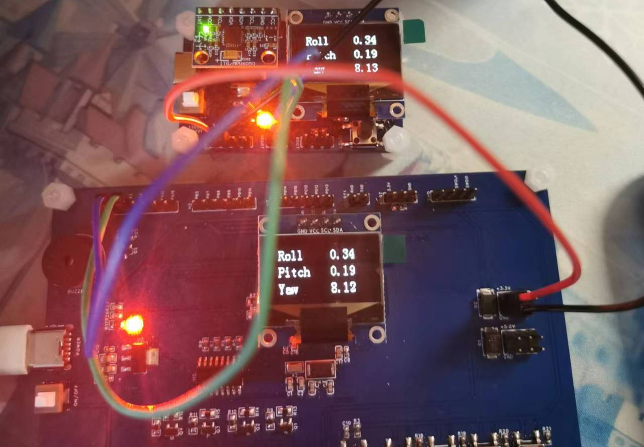

> * Pose display
> ![Pose display.jpg] >
> * n32g430 controller
> ![n32g430 controller(1).jpg]
