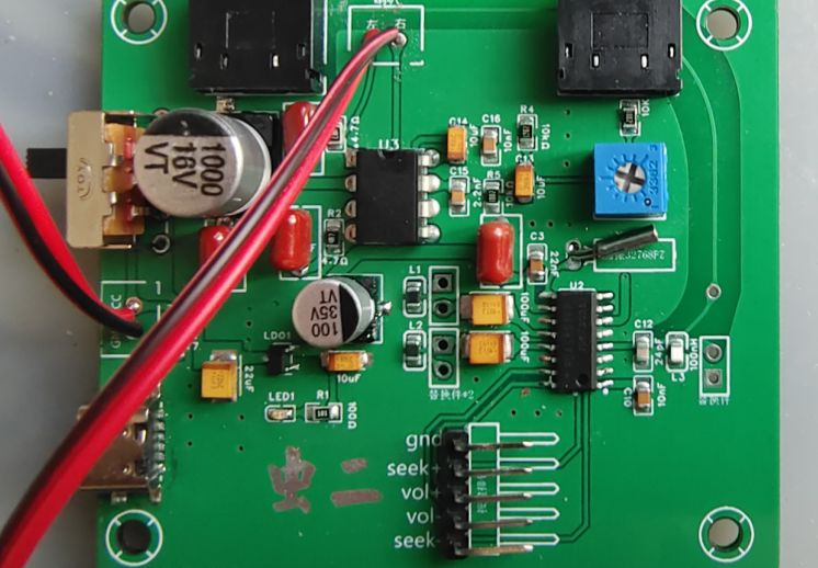

5807fp+2822 power amplifier radio test passed
Final version: The previous version of the antenna has been optimized this time, and a tp4056x lithium battery charging and a dw01 battery over-discharge management chip have been added to solve the problem of battery over-discharge damage caused by forgetting to turn off the power supply.
Version 1.0: 5807fp and 2822 use the classic circuits in the chip specifications. 20 clear radio stations can be received indoors. This is thanks to Jialichuang for giving me the opportunity to learn, and the big guys in the hardware group for selflessly giving me guidance. , the effect is getting better and better. The 1117 used in the step-down chip is still a bit big when the voltage is reduced to 3.3v. I will optimize it again next time and plan to use me6209a33. If there are any shortcomings, I hope you will give me some advice.
