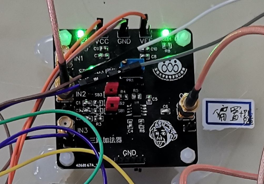

This three-way adder uses OPA690 as the operational amplifier and designs a standard three-way in-phase and inverting adder. You can use short solder SB2, SB1, and SB3 to switch between in-phase and in-phase. At the same time, you can adjust the amplification factor by adjusting RP1. Verified.
