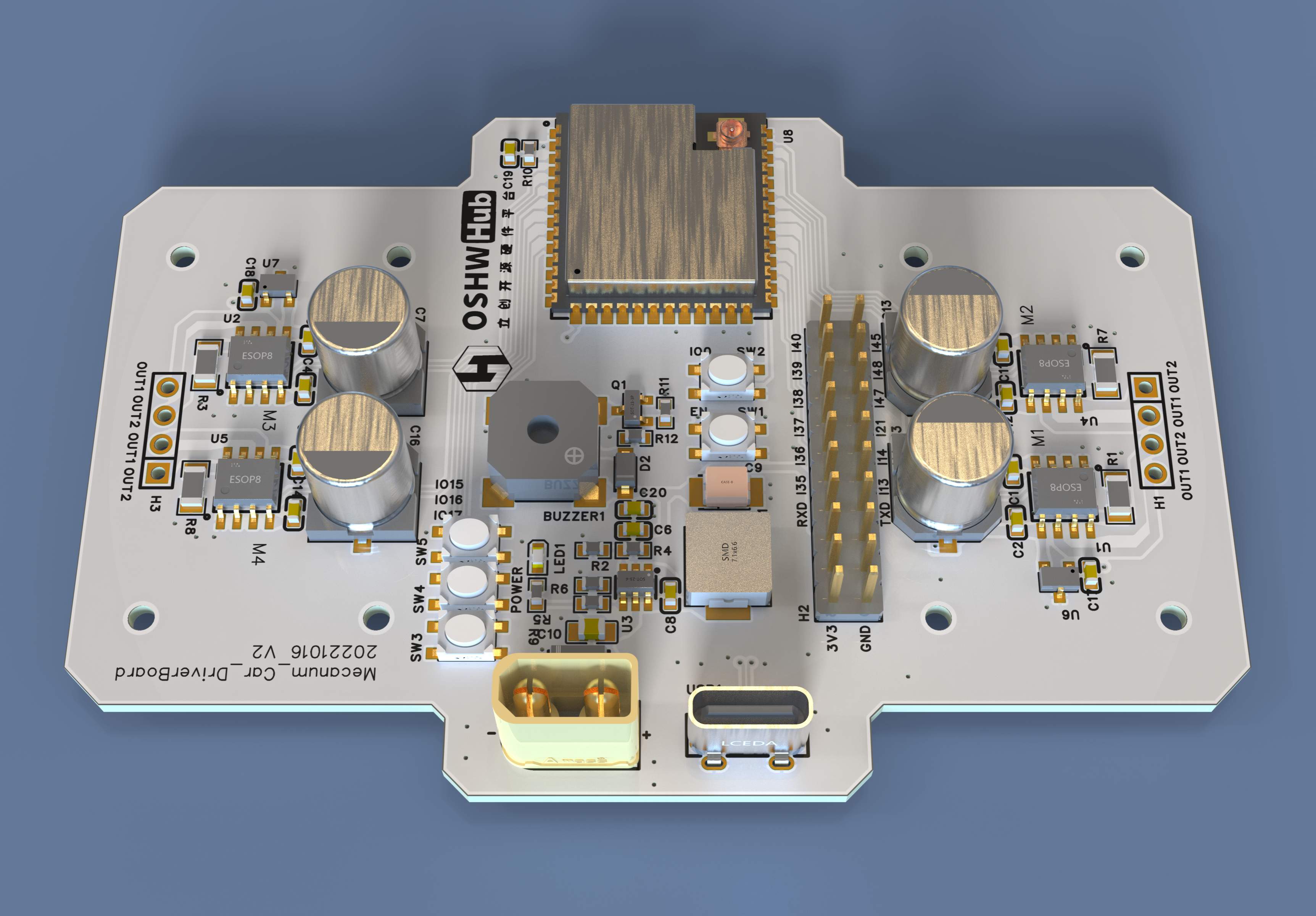

2022-10-09 V1 First version, the current physical picture is this version
2022-10-16 V2 Second version, the problem of the first version of USB being interfered by the wheel was fixed, and the direct plug-in TYPE-C was replaced. Moreover, because it is a pin, the welding difficulty is reduced compared to the first version of the patch, and it is easier to weld. Prepare for verification next week.
2022-10-20 Code differential steering completed + other parts fine-tuning
2022-10-22 V2 is completed, basically filling the shortcomings and can be used normally. The next step is to prepare an expansion board for the board to call MPU6050

Main control: ESP32-S3, in order to reduce the difficulty of wiring, the ESP32-S3-WROOM-1U module is used here.
Motor drive: Four-way AS4950, support high-frequency PWM speed regulation, I soldered Toshiba's alternative material: TB67H450FNG, the two have the same pins and are completely replaceable.
Main control power supply: MT2492, Xi'an Aerospace Minxin, domestic DCDC synchronous buck, up to 16V 2A, SOT-23-6 package, convert to 3.3V.
Buzzer: MLT-8530, SMD passive buzzer
Debug interface: USB JTAG, serial port (serial port to USB required)
Power supply interface: xt30UPB, can use wire to DC head
Motor: GA12-N20 motor, 12V direct battery power, large torque, users can replace 5V by themselves, and then use 7.4v battery, I use 12V power supply.

SMD originals are used, which are smaller and more stable than direct plug-in originals.
Main control ESP32-S3, with built-in Bluetooth/WIFI, no external module is required.
The pin headers on the board are led out, and users can install expansion boards and connect them to the main board through the pin headers.
N20 12V motor, super torque, stronger driving ability.
Mecanum wheel, can move in all directions.
The motor driver supports PWM speed regulation, and an external electronic compass can be used to implement the PID angle loop. By controlling the differential speed of the wheels on both sides, the vehicle can be prevented from running due to installation and terrain.
