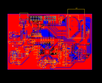

esp32 parallel port ink screen
For the EPDIY v6 version of the board, components should be replaced with the Jialichuang basic library as much as possible. After removing some large components that can be soldered by yourself, the prototype patch costs 200 yuan.
Note that the original version of components is used as much as possible inside the project, and some parts are replaced with accessories that Jialichuang has in stock. The rest, such as the power management chip, you have to buy on Taobao.
Compared with v5, the v6 version mainly changes the power management, and there is no need to change the voltage according to each ink screen. There is only a 39pin interface left on the board. You can use an adapter board to convert the line sequence to adapt to all other supported ink screens.
