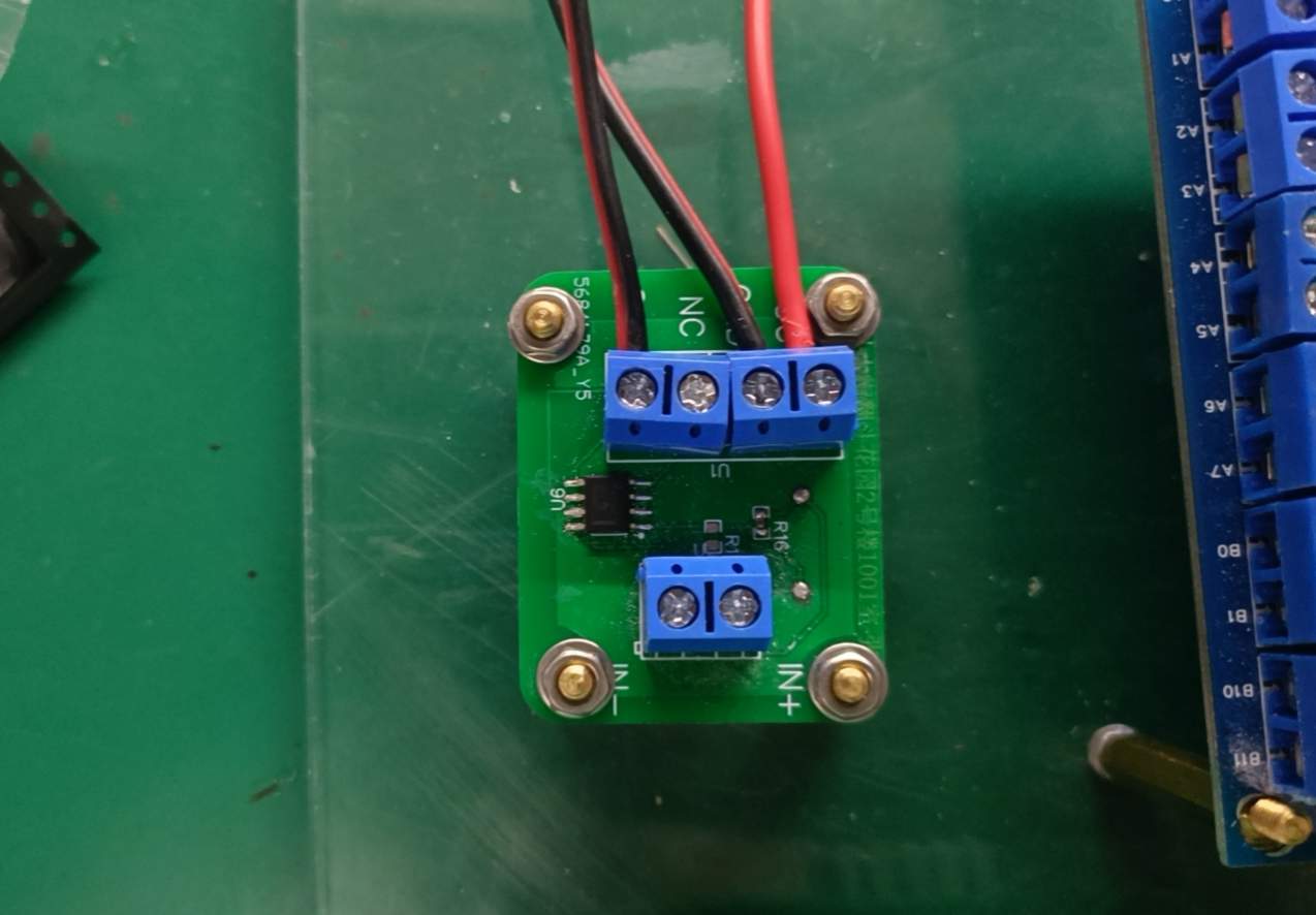

Use INA282 for current sensing, which can be filtered appropriately.
The sampling resistor should be as small as possible to ensure the sampling range.
Use a filter capacitor on the Vout pin to reduce noise.
Use two capacitors for the Vcc pin.
参考设计图片
