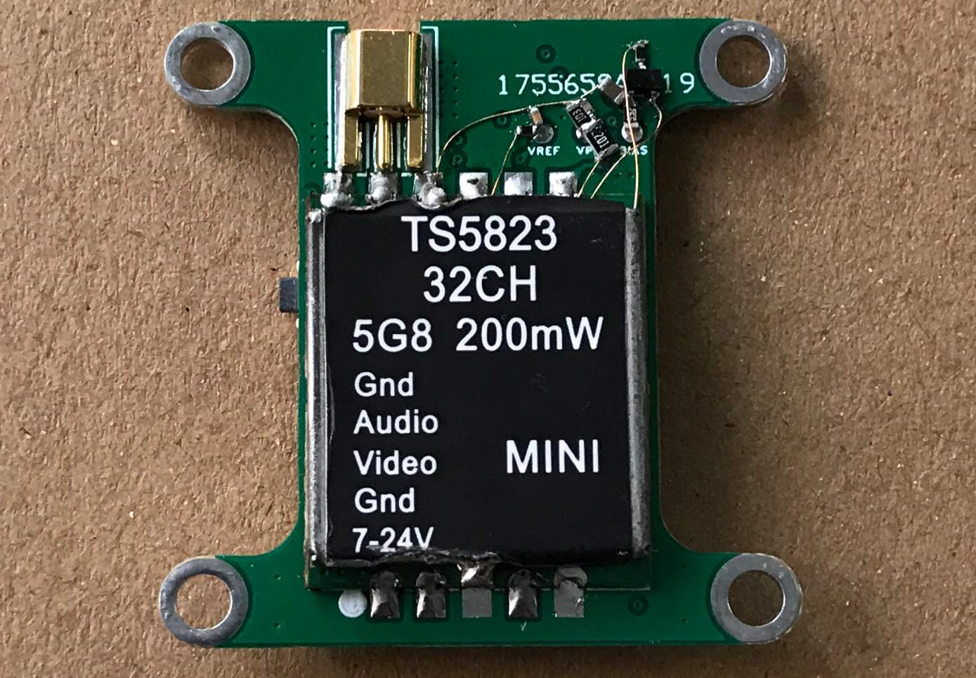

In order to promote popularization, reduce the difficulty of DIY, and improve the success rate, I commissioned a master to draw a DIY image transmission based on the TX5823 module. Features:
1. The radio frequency part uses finished modules with shielding covers. The effect and stability are guaranteed, and it is simple and easy to use. 2. 0603 single-sided components can be easily completed using a heating plate or soldering iron. 3. Pickup integrated with MAX9812 AGC op amp. Finally: the TX5823 module is widely found in old FPV image transmission transmitters, such as Chuangxinke’s TX5828 transmitter. You can even move the board directly to give your old 32ch dial-coded frequency-selected image transmission a new life and have modern product images. All functions of the transmission, even exceeding 200mw, unleashing the maximum potential of the 6659e amplifier!
The general TX5823 module is already SPI controlled for frequency selection when leaving the factory. There is no need to remove the 1k resistor on pin 1 of RTC6705 and the 10nf capacitor on pin 26.
TX5823 is available in 200mw and 600mw fixed power versions. Later, we may introduce how to modify the ordinary TX5823 module so that its PA output power can be freely adjusted.
See attachments for Gerber board-making files, BOM tables, and welding point bitmaps.
For the tutorial on flashing the microcontroller bootloader and firmware, you can also refer to the post in the link at the beginning (note that flashing the firmware requires connecting to the hardware serial port tx of the flight control, and the soft serial port does not work).
Hardware details:
2~6s power input, mmcx antenna interface, 30.5*30.5 flying tower mounting hole pitch, 1.25 6Pin terminal or welding connection. Wiring definition:
AUD external audio input RX Parameter adjustment connected to any TXVXX of the flight control Battery power input positive GND Battery power input negative VID Video input 5V GND - the onboard BEC 5V output can power the camera
