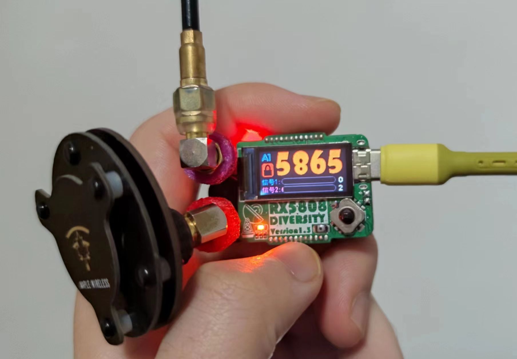

1. The interface design is based on the LVGL
demonstration video, see: https://www.bilibili.com/video/BV1yr4y1371b
1) Long press the OK button on the main interface to lock/unlock the manual channel, short press to enter the menu; to unlock, press up and down The frequency can be adjusted left and right.
2) The menu interface is divided into three parts: Scan; Settings; About.
Press up and down to switch menu options, confirm to enter the submenu, left click to return to the main interface
3) The scan menu has three sub-contents:
the image scan displays the signal strength of the frequency 5300-5900MHz;
the table scan displays the signal strength of the image transmission channel in different colors, and the scan is completed , the frequency switches to the channel with the best current signal strength and is displayed in the upper right corner.
RSSI calibration is used to calibrate RSSI. If image transmission is not turned on, the calibration will fail. If it succeeds, the result will be saved.
4) In the setting interface, you can set the display backlight intensity, fan speed, boot animation, buzzer, etc. to be turned on. The OSD format needs to be saved and re-opened on the main page to take effect.
5) Display relevant information about the interface.
2. OSD supports
OSD function added by Linbaobao (Bilibili ID), non-overlay mode, it can be turned on by unlocking it on the main interface.
See the demonstration video at: https://www.bilibili.com/video/BV1ya411g78U and it is fully synchronized with the receiver UI.
Note: The OSD function is not supported on the original hardware: you need to connect gpio25 to the video (video output).
