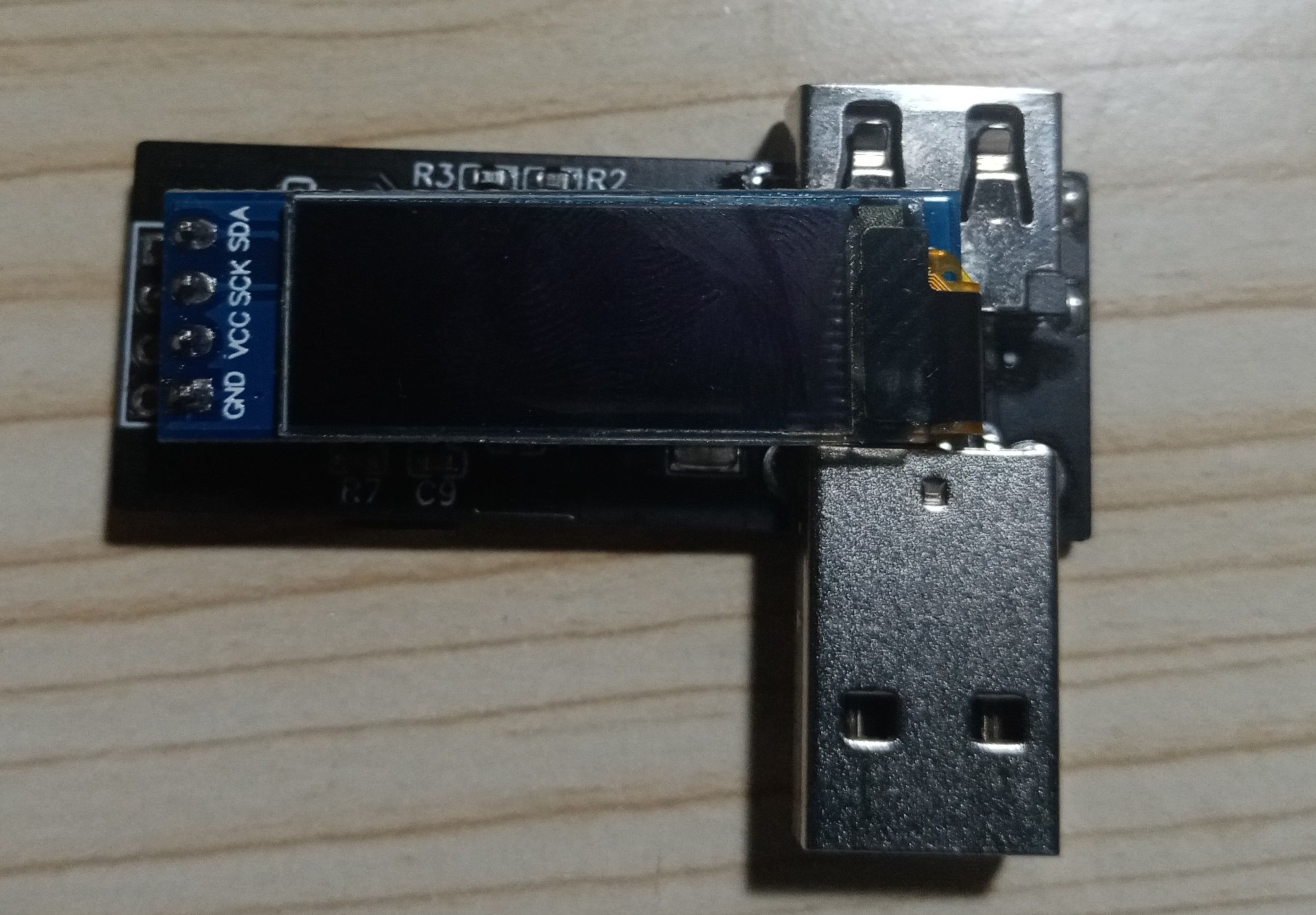

* 1. Project function introduction
Real-time acquisition of voltage and current of USB line, and calculation of power consumption.
The detection voltage range is the voltage range of the adopted AMS1117, and the current upper limit is 2A.
* 2. Project attributes
This project is an original project made public for the first time
Note: Please indicate whether the project is made public for the first time; whether the project is original; whether the project has won awards in other competitions, if so, please describe the details of the awards; whether the project has participated in the defense at school.
* 3. Open source agreement
The open source agreement is GPL3.0
Note: Altruism is self-interest, please read the following content carefully.
Embrace open source and give unlimited value to the project. It is recommended that more than 80% of the core functions of the project be open source;
if a part of the function is irreplaceable and the project cannot solve the corresponding problem after deleting it, then the function implemented by this part is the core function of the project; for example, if an electronic load is designed and a host computer software is designed to monitor power changes, the electronic load is the core function and the host computer software is an auxiliary function; for example, an isolated 485 module is used in the electronic load to communicate with the host computer, then the communication function implemented by this 485 module is an auxiliary function;
the project should choose an open source protocol that suits it. If the project references other open source projects, the source should be indicated and the original author's open source protocol should be followed; the original project is recommended to use the GPL3.0 open source protocol;
the functions directly referenced from the original circuit or original code of the open source project cannot be used as the core functions of your own project, and the functions directly implemented using the general modules on the market cannot be used as the core functions of your own project.
*4. The hardware part
is designed by Jiali Chuang EDA.
The main control adopts the national technology N32G430C8L7. The N32G430 series adopts the 32-bit ARM Cortex-M4F core, with a maximum operating frequency of 128MHz, supports floating-point operations and DSP instructions, integrates up to 64KB embedded encrypted Flash, 16KB SRAM, integrates rich high-performance analog devices, built-in 1 12bit 4.7Msps ADC, 3 high-speed comparators, and integrates multiple U(S)ART, I2C, SPI, CAN and other digital communication interfaces. USB to ttl burning is adopted, and the wiring method is R to R and T to T when in use. The power supply interface is reserved, and the power supply sampling ams1117 can be directly used to convert the voltage to 3.3v
