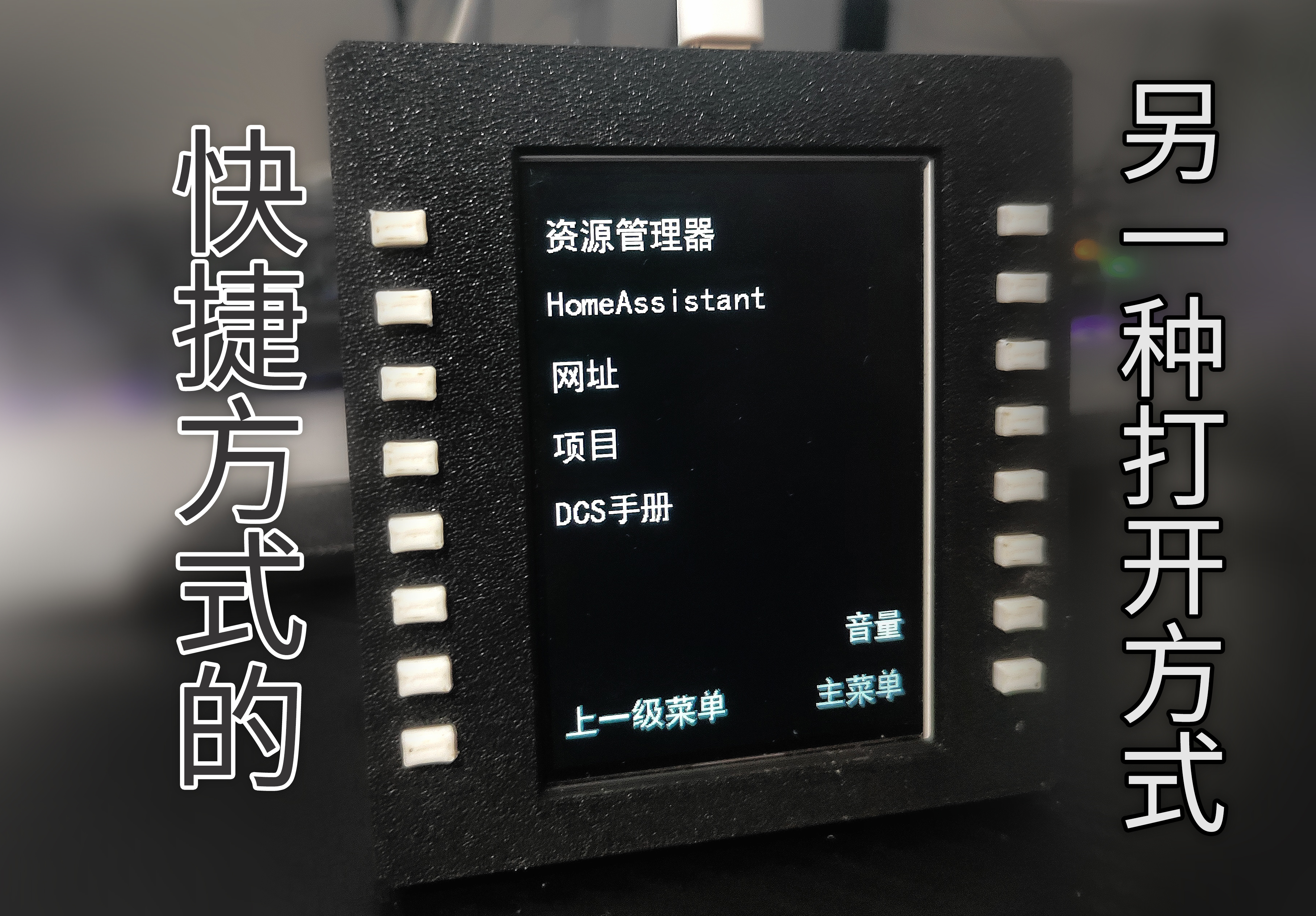

A desktop shortcut control center made of a multi-function display can quickly open various applications, files, or customize codes to achieve more functions in combination with the host computer.
The original idea came from the multi-function display of the JF-17 "Xiaolong", which uses double-column buttons on both sides for control. When applied on the desktop, you can quickly access the required content with one hand. Similar functions can have a start menu and use the desktop directly, but they all need to cut out the software to open the taskbar operation. This project can expand the operation space, which can be conveniently operated in many cases and give users more choices.

The hardware part uses ESP32-S2 master control, drives 3.5-inch 16-bit parallel port MCU display, MCP23017 expands IO port and connects to surrounding buttons. The software part uses
ArduinoFramework in PlatformIO environment, and the display driver library is ArduinoGFX
The host part is written in C#, and serial communication

host computer: The left side is a tree view, showing the menu list. Add a node Edit menu -> Add child node or root node at the top of the software. The root node is the home page content, and the remaining child nodes must select its parent node and add it.
Node attributes: The node positions are 0-5, 8-15, corresponding to the first 6 buttons on the left and the first 6 buttons on the right respectively; Node type: If it is a "folder" with child nodes, select List, if you press to execute the actual command, select Command;
Node action: OpenFile is to open the file, which can be a specific file, path (open in Explorer), URL (open in default browser). Node data: Fill in the data of the node, for OpenFile it is the path, URL, etc. The node name is the name displayed on the screen.
On the right side of the interface is a list containing the above parameters, which corresponds to the parameters of the currently selected node. After modification, press Save to automatically save and synchronize with the device. To
delete the node, select it and find Delete in the Edit.
Lower computer: Just press the corresponding button, buttons 7 and 15 are reserved, the corresponding position of No. 7 is the name of the parent node, No. 15 is expected to display time, etc., to be developed.
