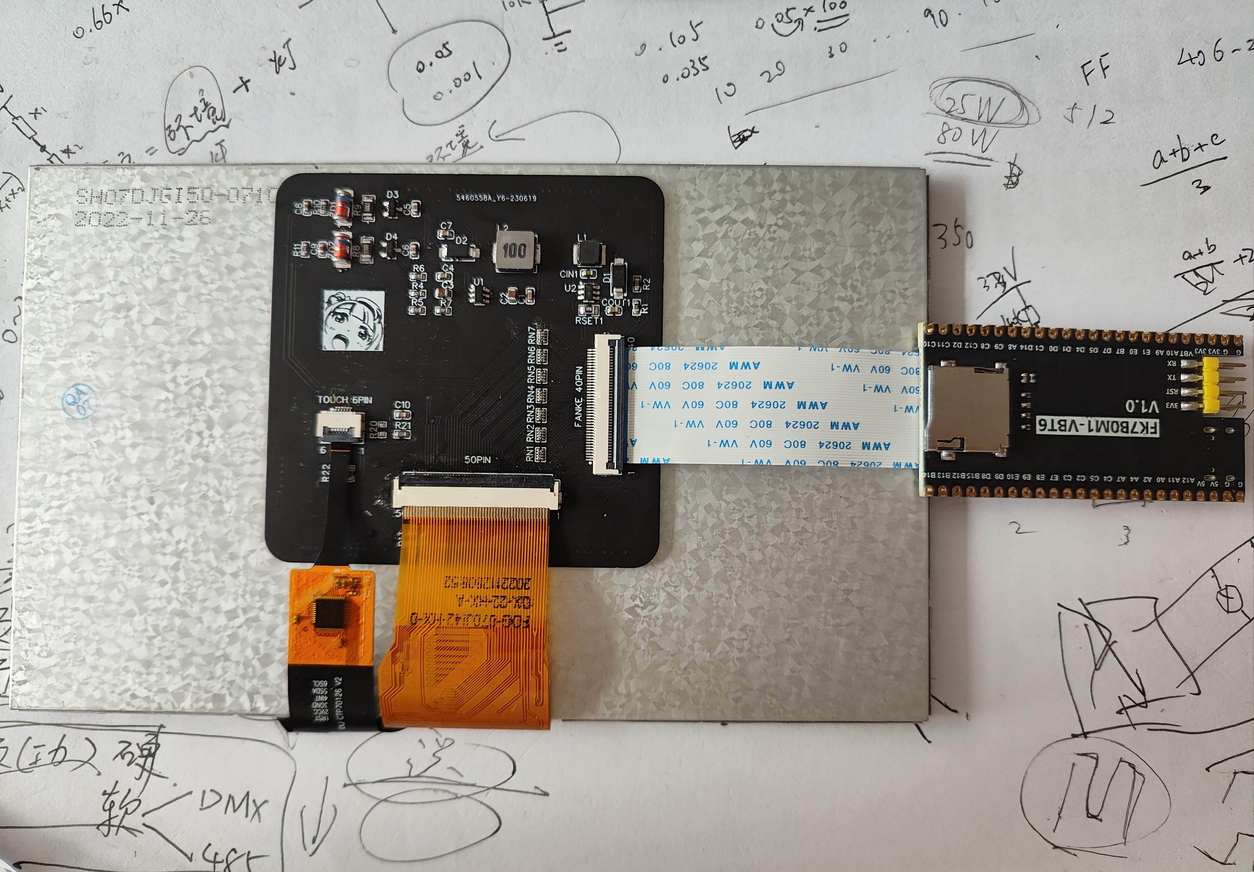

50PINRGB converter technology 40PINRGB
Pay attention to R20
and 50PIN FPC welding. Be careful not to solder or short circuit.
The project uses 2 DCDCs. If the screen does not have AVDD voltage requirements, it can be saved as 1
screen and uses Yao Yuanhong 7-inch TFT IPS screen.
