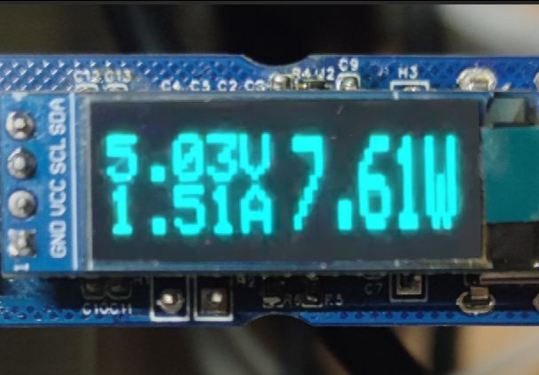

* 1. Project function introduction
A USB ammeter can be connected to the USB interface, with a small screen to display the current, which can display the current in real time
*2. Project attributes
This project is a project for the Jiali Chuang 2022 summer training camp, not original.
* 3. Open source agreement
This project is all open source
*4. The hardware part
uses the N32G430C8L7 microcontroller, with a maximum operating frequency of 128MHz, supports 40 reusable I/Os, provides a wealth of high-performance analog interfaces, and provides a variety of digital communication interfaces, including 4 U(S)ARTs, 2 I2Cs, 2 SPI/I2Ss, and 1 CAN 2.0B communication interface.
The N32G430C8L7 microcontroller product can work stably in a temperature range of -40°C to +105°C, with a supply voltage of 2.4V to 3.6V, and provides a variety of power consumption modes for use.
In order to save the area occupied by the buttons on the PCB, the reset circuit and the boot circuit do not use buttons, but two solder joints are used instead. . .
Burning interface
sampling circuit
display module
