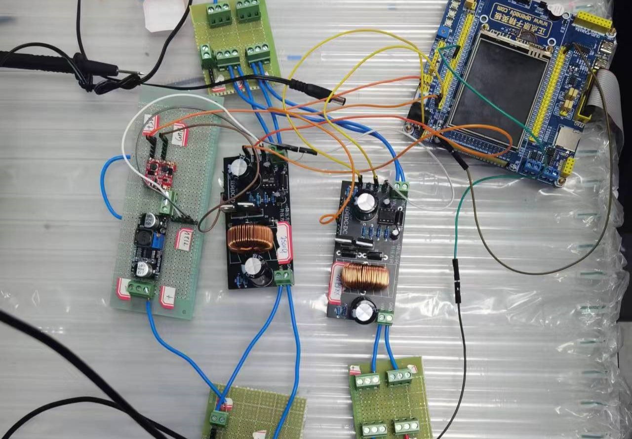

The design scheme uses two control boards, one for boost and MPPT control; the other for bidirectional DC-DC control. The control process is as follows:

First check whether the line connection has open circuit, short circuit and cold soldering. After confirming that it is correct, connect the multimeter to each test point. First debug the bidirectional DC-DC part, calibrate it, and then increase and reduce the load to achieve constant output while charging and discharging the battery.
When debugging the input boost DC-DC part, calibrate it, further debug the working process under different loads, and observe the results of PID adjustment output during MPPT tracking.
System joint debugging, according to the requirements of the topic, connect the system, adjust from 55V to 25V, adjust the load to 25Ω and 50Ω, record it, and then calculate and analyze it.

Deviation No.1 2 3 4 55.00 50.00 45.00 35.00 27.53 25.01 22.5 17.51 ​​00.03 00.01 00.00 00.01 6. Performance Part 2: Under  the conditions of =35V, =1.2A, and efficiency record    converter efficiency No.1 35.0 1.202 30.02 1.75 17.51 ​​0.48 14.89 95.49 % 2 35.0 1.200 30.01 1.76 17.50 0.47 14.80 95.40% 7. Performance part 3: =35V, reduced from 1.2A to 0.6A, load regulation rate record  load regulation rate sequence number 1 35 29.99 29.98 0.03% 2 35 30.97 30.97 0.0% 3 35 30.97 30.98 0.03% 4.3 Test result analysis When using a DC power supply, the input current remains at 1.2A, the input voltage drops from 55V to 25V, the output voltage is stable at 30V0.1V, and the energy storage port current changes from inflow to outflow, realizing automatic switching between modes I and II. The converter efficiency is above 95% on average, and can achieve maximum power point tracking with a deviation of no more than 0.05V. Under the given conditions, the system's load regulation and voltage regulation meet the requirements of the question. 5 Other systems are also designed with key functions to calibrate the system's voltage, current and other parameters. The system's final output voltage can not only be stabilized at 30V, but its stable output voltage can also be changed by key adjustment.
