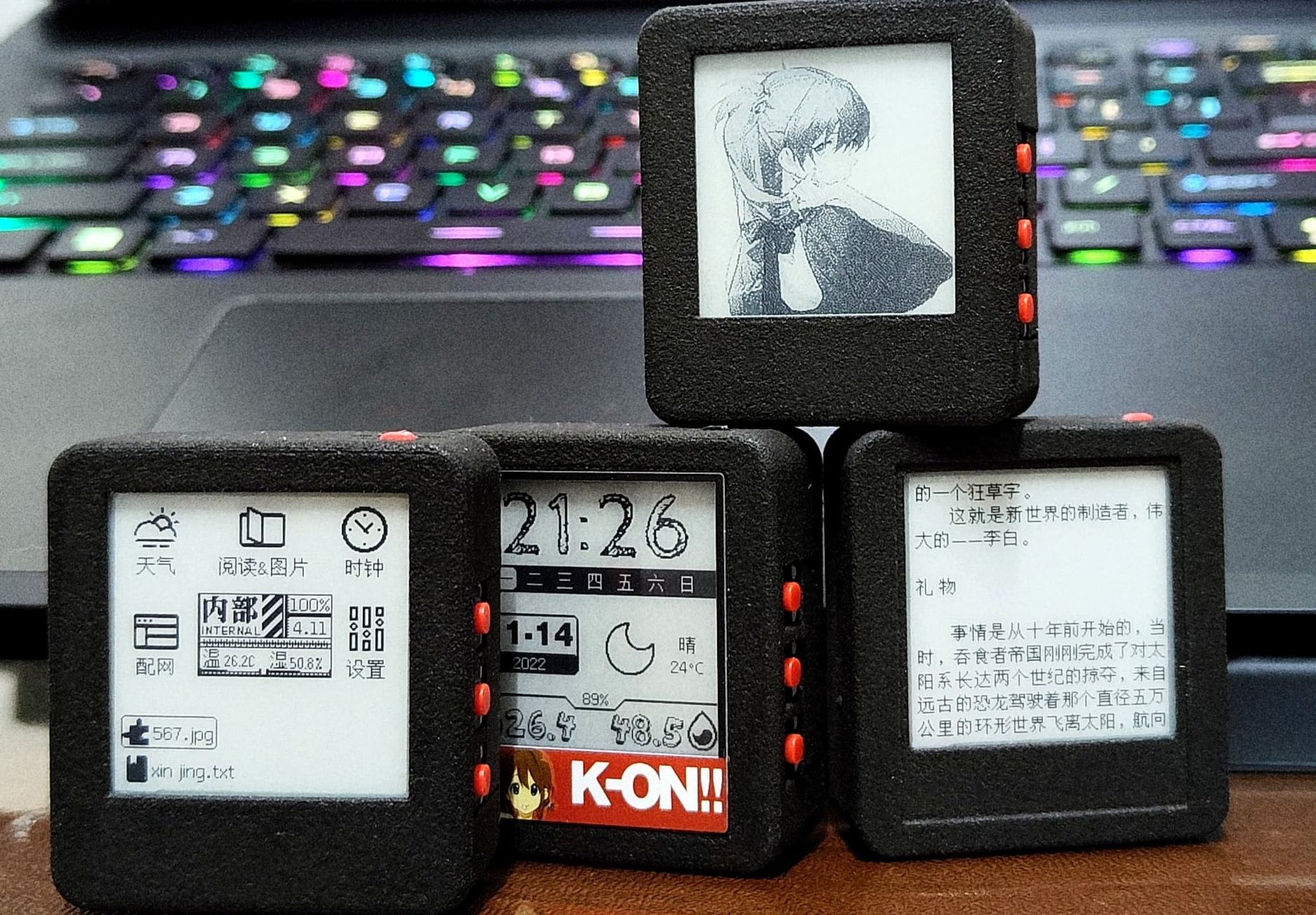

1.54-inch multi-function ink screen
Inherits all the functions of 2.9 inches (clock/weather/reading/picture/network configuration/settings/SD/temperature and humidity/OTA)
and adds JGP decoding function, using real 4 grayscale + pixel jitter to make the picture show more details

There are two different panel versions of the shell, and the PCB
uses 3 Kaihua mouse mute buttons for a comfortable feel and long life (10 million times)
SHT30 temperature and humidity chip, RX8025T clock chip
Extremely advanced Type-C interface, 500mah lithium battery, sleep current 31ua
Support SD card, maximum 32G
