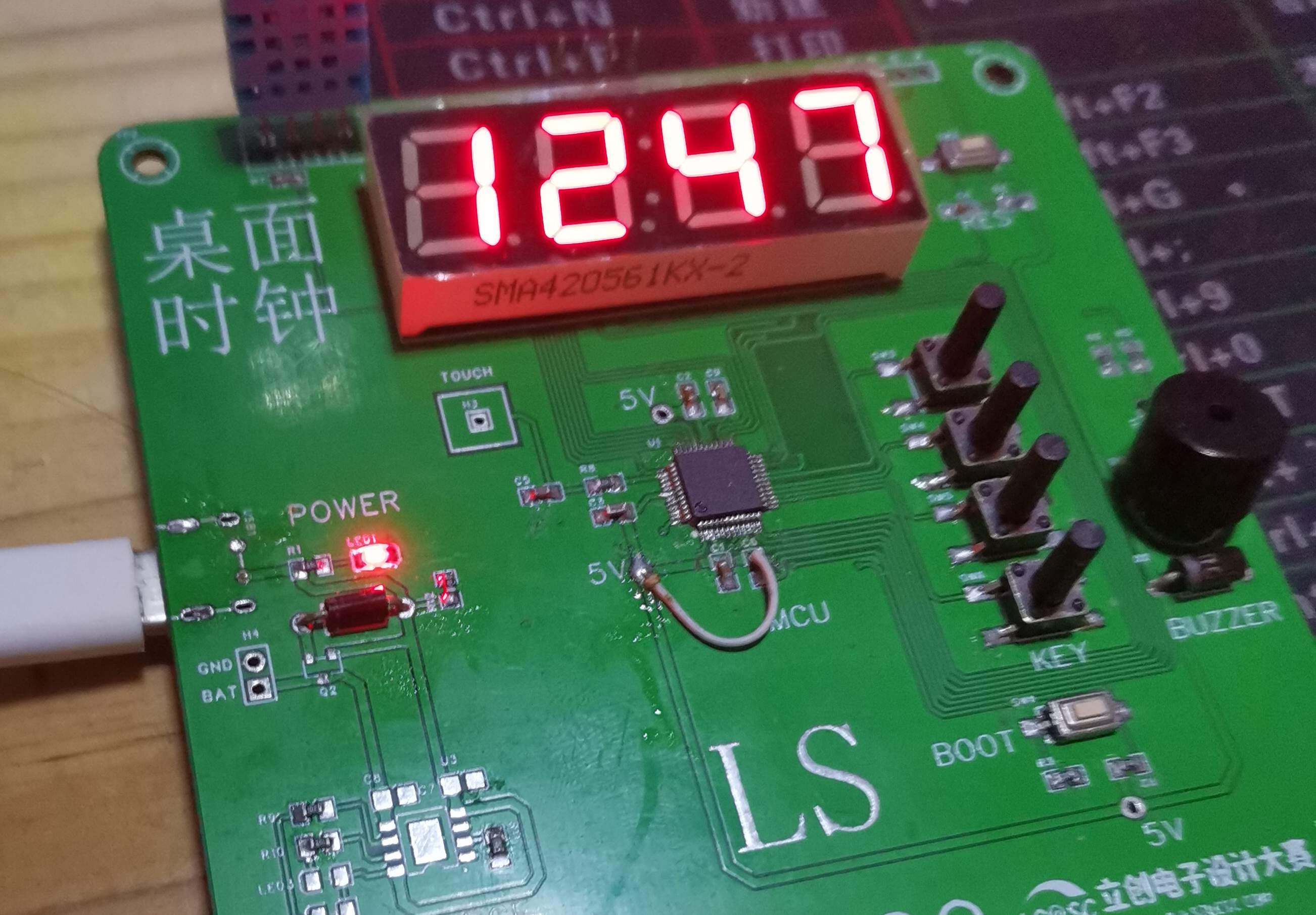

* 1. Project function introduction
Desktop small clock, digital tube display, supports display of temperature and humidity.
* 2. Project attributes
are disclosed for the first time, original
* 3. Open source agreement
GPL3.0
Please fill it out during the competition stage↓
* 4. The hardware part
is designed by LiChuang EDA.
Use A2E1 chip as the main control
Independent button to adjust the time
Designed reset circuit and boot circuit
Type-c interface design, durable and easy to use
Designed buzzer drive circuit
Reserved battery interface
TP4056 charging circuit
Use mos tube to design battery switching circuit
0.56-inch super large digital tube
Use DHT11 for temperature and humidity detection
Type-c interface package bought wrong, soldered on the back
Charging circuit can be soldered when using battery, no need to use type-c power supply
