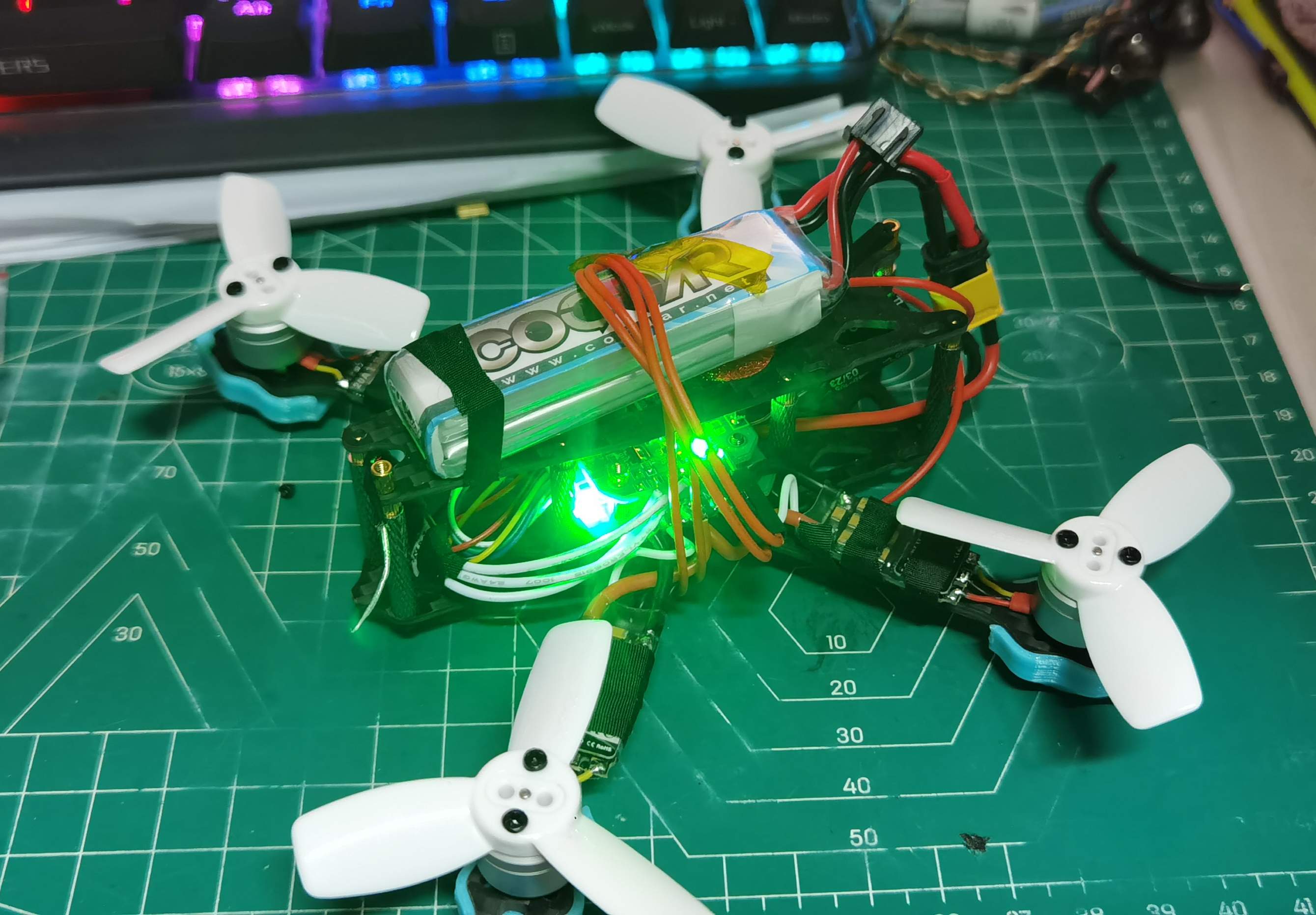

This project should be called a cheap installation plan for a cross-country drone rather than a flight control design. The flight control design is basically copied from several naze32 boards on the current platform and then modified casually, which reduces some welding difficulties. It is a reference for people like me who have no money but want to make a decent cross-country drone/quadcopter. Don't ask me why I don't just buy a mobula, because the purpose of making this thing is actually more to tinker with it rather than let it fly...
Finished product:
Can fly normally
https://www.bilibili.com/video/BV1cu411b7Rr/
The conclusion of the test flight is that the combination of 2s+Bai Cai 1104+3018 is too weak for this system. The throttle for takeoff with full power reaches 50%, and the throttle for hovering is estimated to be 60%. It feels very weak, and the battery life is only about 4 minutes. In addition, the motor and battery will be slightly hot after flying, which is obviously too heavy. The solution without upgrading the entire power system is to replace the battery with 3s. As for the effect of 2345 propellers, it has not been tested yet.
2. Overall solution
Flight control: naze32 flight control bf3.2.5 firmware
Frame: Johnny 3-inch frame
ESC: blheli split ESC 20A * 4
Motor: Taobao/Xianyu 1104 cheap brushless motor 4300kv
Battery: Eagle Krypton 2S 500mah 100C
Propeller: two options, 2345 propeller or adapter + 3018 propeller
Remote control: Fusi i6
Receiver: rx2apro
Image transmission and FPV part: no, this thing is too expensive, if you really want to buy it, the cost is higher than the above combined, you can only fly visually
Cost calculation: flight control (20) + frame (35) + motor (50) + ESC (100) + battery (30) + propeller (15) + remote control and receiver (200) = 450, so you can have a plane that can fly.

The flight control is designed with a 20*20mm hole spacing (F4mini type), and the overall structure is a pseudo-flying tower design of flight control (4-layer board) + power distribution board (2-layer board). The battery is directly connected to the power distribution board, which can reduce the voltage of 4s and less batteries to 5v, and leave 4 groups of split ESC pads; the power distribution board is connected to the flight control through a 1.25 6p cable, and the 6p is 5V GND, M1-M4 pwm signal respectively.
The flight control is not much different from several naze32 projects on the platform. It is just to reduce the difficulty of welding, the mpu6050 in the qfn package is replaced with the ready-made gy521 module, and the pwm receiver interface is deleted. No one really uses this thing, and the layout is changed to the exposed pad like the current mainstream flight control for easy welding. But one of the bad things about this version of the design is that there is no onboard usb serial port chip and usb socket (mainly because the size is a bit small, so it was deleted when designing the layout for laziness), resulting in the need to connect the firmware and parameters to the external usb-uart module through the flying dupont line.
