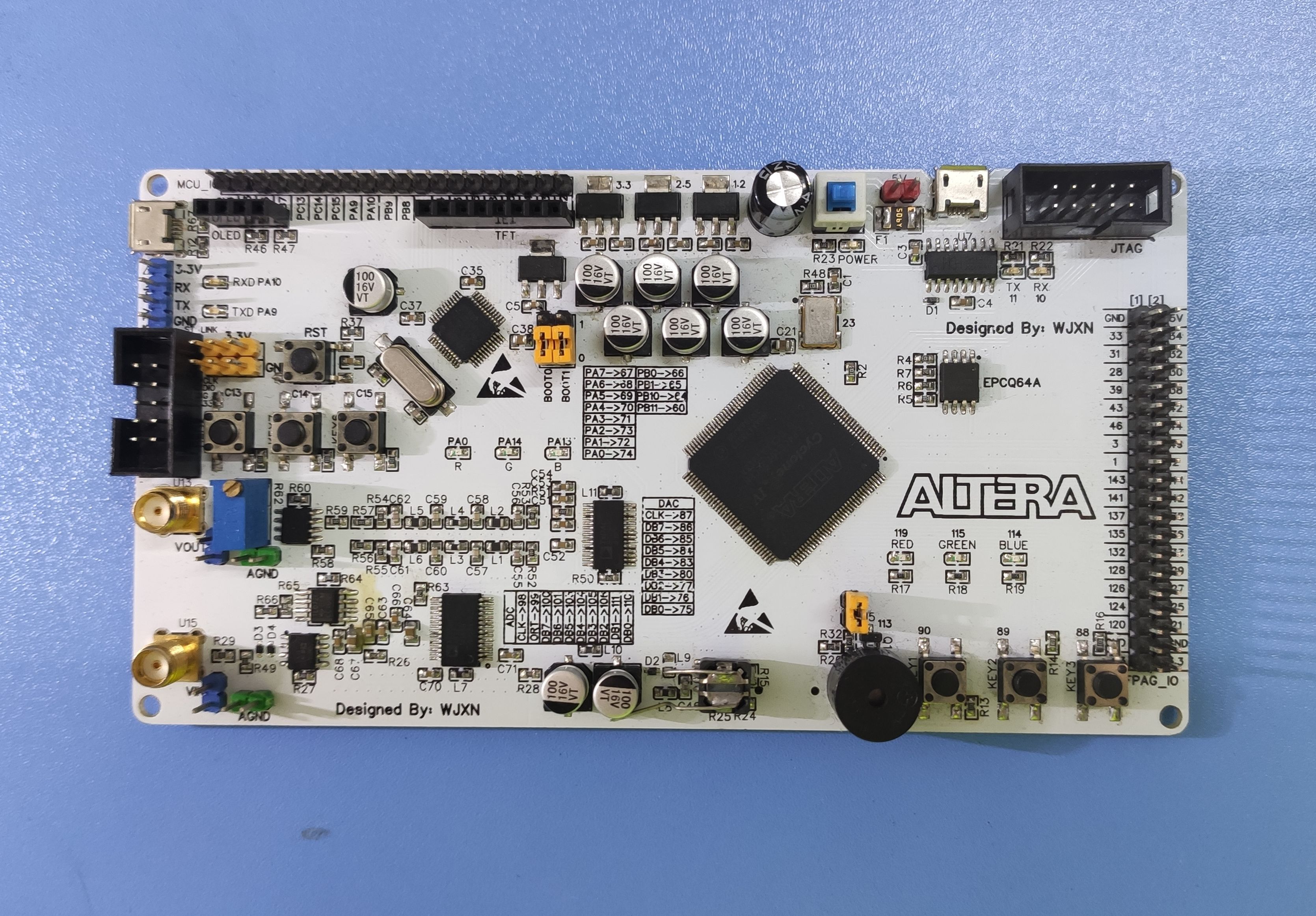

This design is an FPGA+STM32 development board, which can process high-speed signals and has 8-bit parallel high-speed AD/DA to meet the design needs of e-sports signal topics. (This is probably the board I’ve taken the longest to draw)
Onboard resources: cyclone IV EP4CE10E22C8N, STM32F103C8T6, AD9708, AD9280 and some other peripherals, leading to a total of 34 FPGA independent IO ports, 18 STM32 independent IO ports, reserved TFT, OLED screen interfaces.
Typical applications: FPGA processes high-speed signals, and STM32 processes display and communication, such as high-speed DDS, oscilloscopes, frequency meters, etc.

Finished product picture: front
