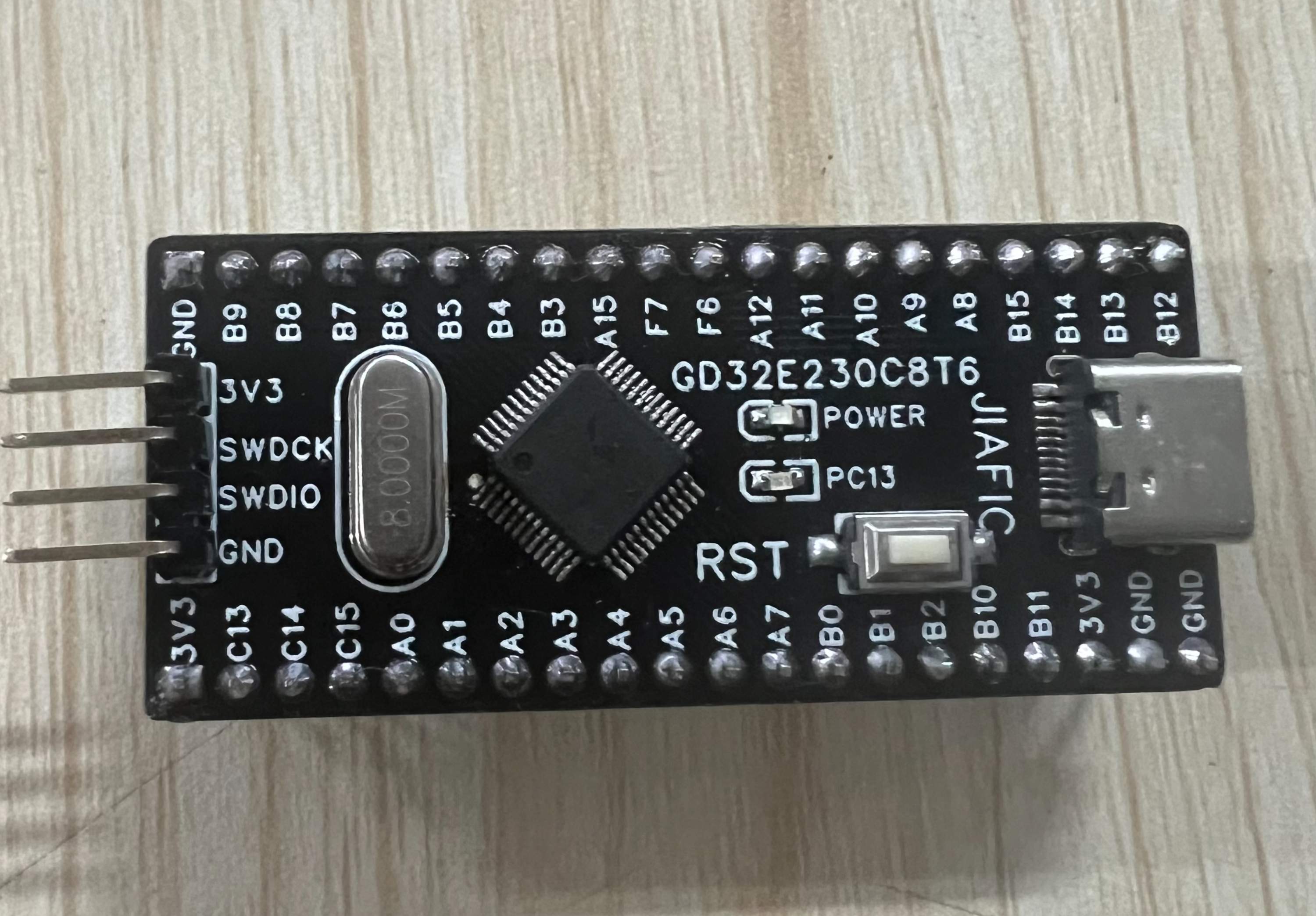

GD32E230 minimum system board
There are a few GD32E230C8T6 chips left on   the GDE230C8T6 minimum system board.  I drew a board
and played with it. I have tested the board and verified that there is no problem.
R5 and R4 are BOOT selection resistors. Choose one of the two. Connect BOOT0 to the 10K resistor to ground to boot from the main storage ( Normally select this), connect BOOT0 to VCC high level to start from the Bootloader.
The materials selected are cheap and common, which saves costs and are easier to weld. The following is a manual welding diagram
download program. It is almost the same as stm32. I use stlink for downloading. You can use the serial port for burning. Please see the attachment for the official download tool.
