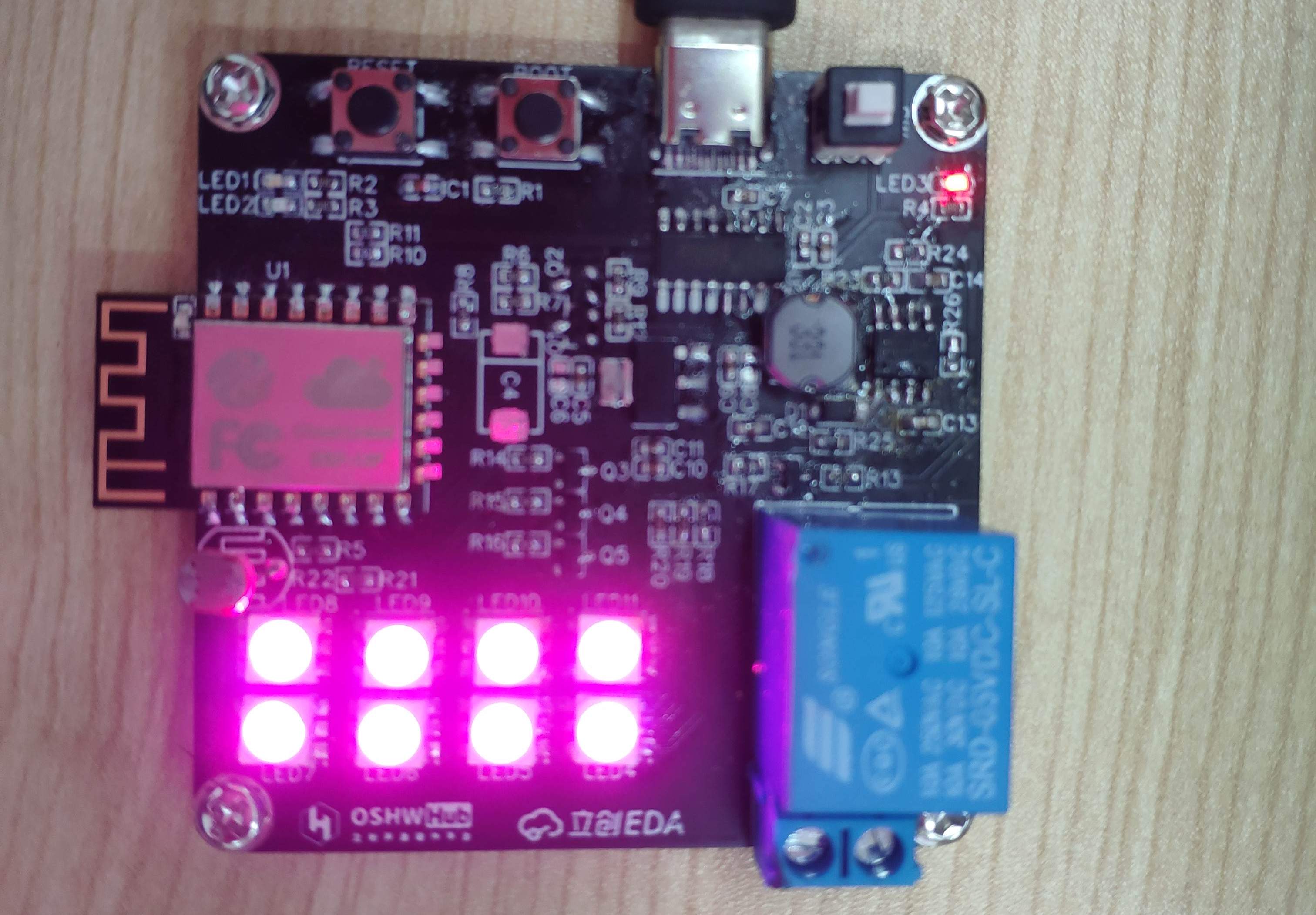

Introduction : Use esp8266 to connect to the lighting technology platform, and you can use Tmall Genie and Xiaoai voice control. There are relays, RGB lights, and photoresistors. Use ESP8266 to learn the data upload and distribution of lighting technology. Developed using Arduino IDE, it is easy to get started and you can quickly understand the use of the Internet of Things. ESP8266 can also be used to connect to other cloud platforms to implement IoT functions.

Summary: After completing these four steps, you can learn the basic data upload and distribution of the Dian Deng Technology IoT platform, and voice assistant access. The attached C file is the same code as the Arduino code, which implements lighting APP, LED control, relay control, RGB control, photoresistor value upload, and adds Xiao Ai to control the LED switch.
Outlook: After completing this, if you are interested in the Internet of Things, you can continue to add the button (GPIO0 button) distribution function. The Dian Deng Technology platform encapsulates the Internet of Things process, which is suitable for igniting students' interest in learning the Internet of Things. It is recommended that students who are interested in the Internet of Things continue to use this development board to learn other Internet of Things platforms. Suggestion: Ali Life IoT Platform (i.e. Ali Feiyan Platform) is very good. Alios things developed by Ali can quickly connect to Ali Feiyan Platform. Alios things address: https://github.com/alibaba/AliOS-Things/blob/rel_3.1.0/README-zh.md
