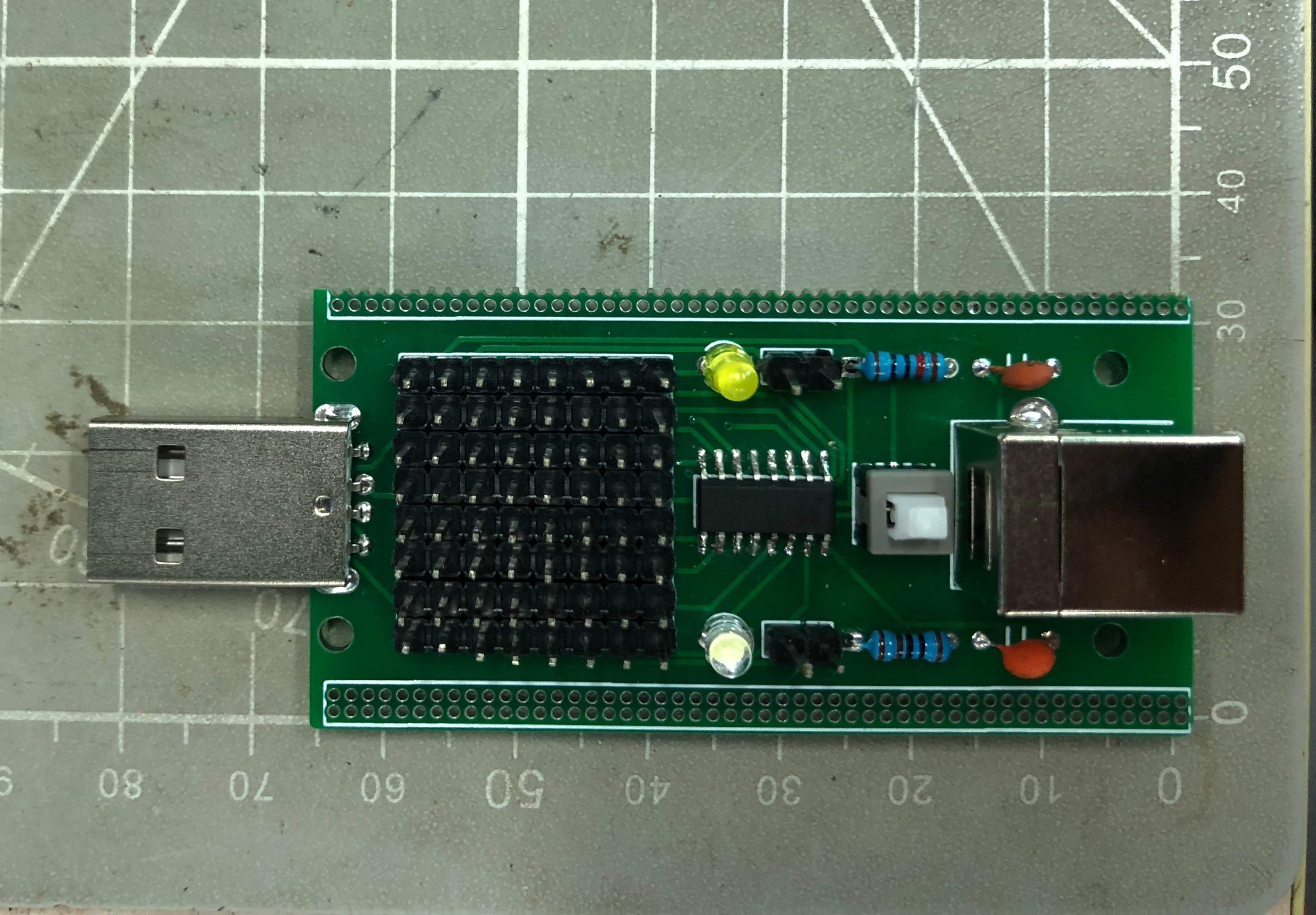

2022Q3-CH552G-DIY
1. USB-A free serial port chip download
         (need to short-circuit the 2P pin header of V33 and +5V 2P pin header)
   PS: After downloading, you need to remove the short-circuit pin header of V33 to operate normally
         (otherwise, it will automatically enter the download The mode will not run the code)
2. The USB-B interface is relatively strong (personally prefer it)
3. Except for the MCU, they are all plug-ins (the handicapped party is ecstatic)
4. The BOMCOST is extremely low (the student party is ecstatic)
5. There are 4 rows of pin headers , you can directly customize it
    and use it as a breadboard or badusb.
