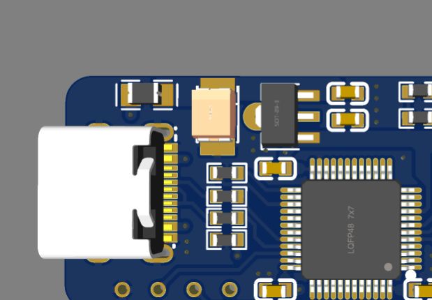

The two STLINKs I bought before were all burned. The output IO ports were all broken.
I was heartbroken, so I drew this ST-LINKV2 with ESD protection.
Features:
A 100uf capacitor is added to the input to make the power supply more stable.
Simplified some unnecessary components and removed the 5V output (to avoid connecting the wrong voltage)
Current limiting resistor and ESD protection added to output
All original parts are concentrated on the front, making it convenient for teppanyaki
Proofing and verification passed
Note: The LDO pin is a bit special and different from the usual ones.
