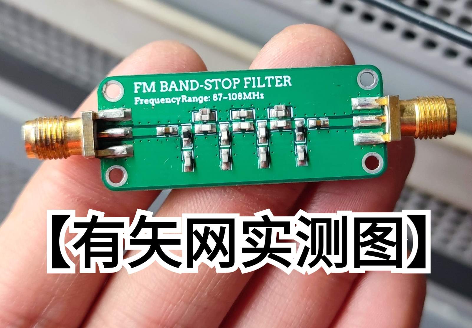

       FM band stop filter (notch filter). Usually used for satellite receiving front-end, SDR software radio receiving front-end. Too strong FM signal may cause the LNA to be blocked, affecting the quality of the signal to be received, so an FM band stop filter is needed to filter out the local FM that is too strong. Signal.

★Calculate impedance and draw PCB:
Here the CPWG model is used for calculation.
So please do not change the PCB copper layout and line width, as well as the board thickness (1.2mm) and the placement of components unless you know how to deal with impedance.
★Make the physical PCB and weld it:
★Connect the welded filter module to the vector network analyzer, conduct actual measurement, and evaluate the effect:
Here we measure the S21 parameters of the filter.
Here we measure the S21 parameters of the filter, connect the input of the filter to network branch port 1, and the output connection port 2, start Measurement.
★By observing the S21 parameters, this filter has good effect.
Some people may ask why the insertion loss is different from the simulated one. The simulated insertion loss is 0.several db, while the measured insertion loss is several db, and the stopband frequency has changed slightly. Variety?
Obviously, simulation and reality cannot be completely consistent. Simulation uses an idealized model for simulation, and reality is subject to the parameter errors of components, materials, plates, etc., which is a normal phenomenon.
It can be seen from the S21 parameters that the effect of this filter is already very good.
★Here is another measured picture of S21 parameters in the entire range of 9KHz~4GHz.
The higher the frequency, the greater the insertion loss. This is also a normal phenomenon and is caused by the components themselves.
