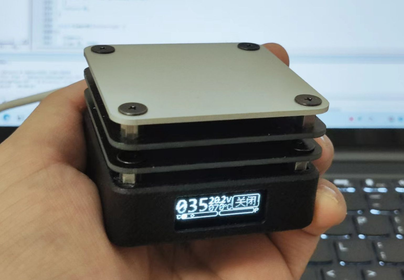

[PD protocol | High appearance] mini heating table
The protocol chip uses IP2721 to trick out a 20V voltage.
The display uses a 0.91-inch OLED module.
The main control chip is STC8H3K32S.
Because the heating platform is too small, the screen almost occupies the entire front of the fuselage, so the buttons can only be set on the back of the fuselage.

and the display mode can be changed at the same time. The display modes include detailed information display mode and temperature curve mode. The detailed information interface will display temperature, power supply voltage, heating status, power and other information (the picture at the beginning of the article is the detailed information display mode)

2. Hardware
M3*12mm double-pass studs*4; //Cannot be too long or too short
M3*5+6mm single-pass studs*4; //Not recommended to be too short or too long, can be slightly longer
M3*5 double-pass studs*8; //Not recommended to be too short or too long, can be slightly longer
M3*3 flat head screws*28; //Screw length <= (short double-pass stud length + 2*1.6)
M3*8 flat head screws*4; //Cannot be shorter, can be slightly longer, 8<=length<=10
M3*3 copper flower nuts/inlaid nuts*12;
P100 test pin * 2; //Use the test pin to connect the mainboard and the heating plate. It is recommended to use a round head with a length of about 33mm
PT1000 platinum resistor; //Used for temperature measurement
Copper flower nut/inlaid nut↑
Main control board↑
Close-up of the relative position of the test pin hole and the screen↑Close
-up of the test pin after installing the aluminum substrate↑
Use thermal conductive glue to stick the thermistor under the aluminum substrate (aluminum side facing up). The resistance of the aluminum substrate is about 6 ohms. When powered by 20V, the power is about 65w. If you want to increase the power, please increase the width of the aluminum substrate wiring.
The screen connector and the thermistor connector on the main control board can choose to weld the socket or directly weld the wire. Pay attention to the line sequence of the screen interface. Thermistor has no polarity.
Install the button into the shell.
Screw the long screws and copper flower nuts on the bottom plate and place them on the bottom of the shell (pay attention to the direction), then install the mainboard into the shell from the side of the button and use the copper flower nut to fix it to the bottom plate.
Install the 12mm stud into the shell, tighten the bottom plate screws, and connect the screen and thermistor to the mainboard.
Install the top plate, use 5+6 single-pass studs to fix the top plate to the outer shell, and then install the heat insulation board in turn. (Note the direction of the reserved test pin hole)
Insert the test pin (the test pin does not need to be welded), weld the thermistor connecting wire, and tighten the screws to fix the aluminum substrate.
Done! (The Taobao details page of the test pin shows that the maximum current it can withstand is 3A, which is enough.)
