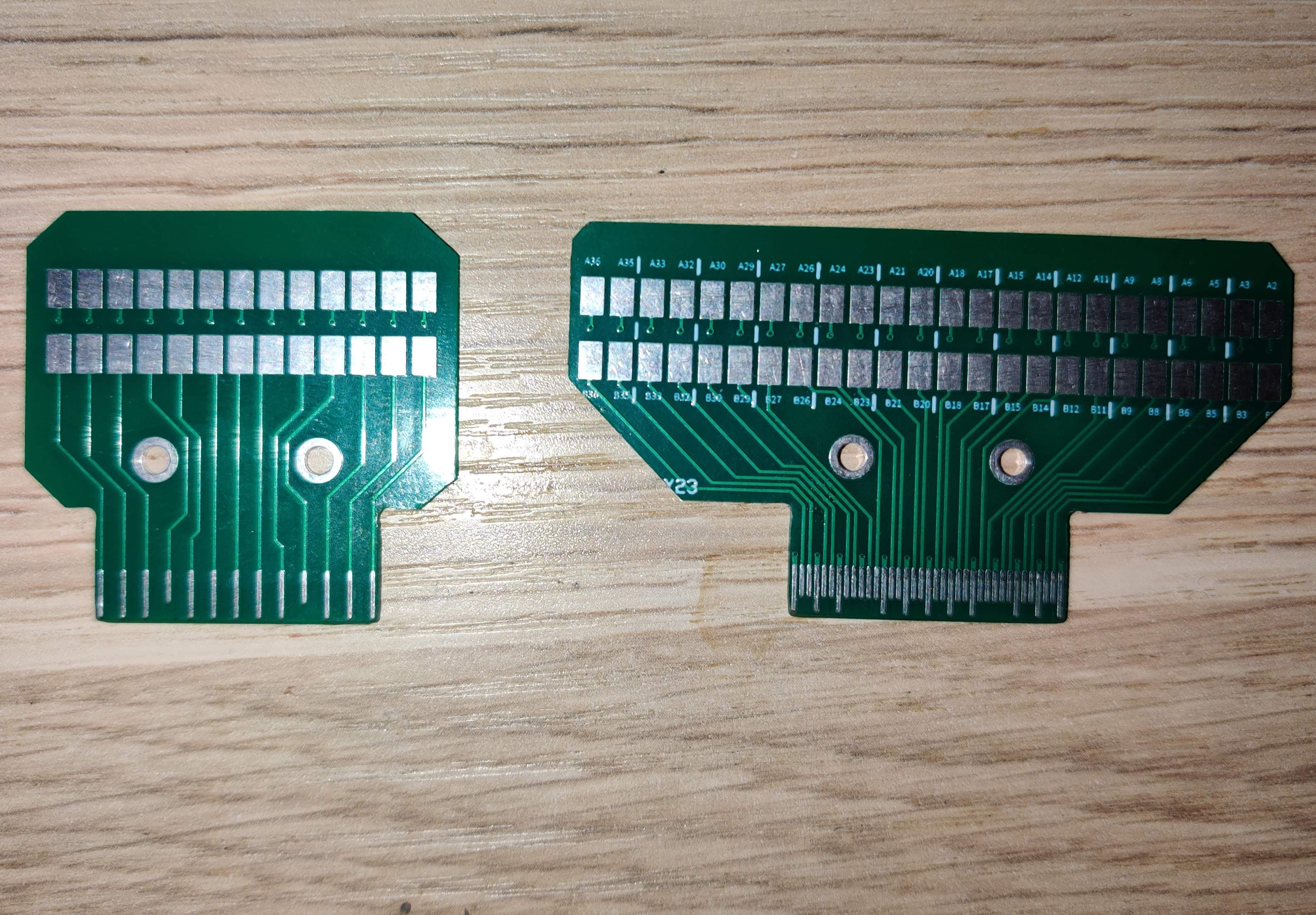

sff-8654 8i test board
Because the pins of the socket are hidden underneath, it is easy to overturn when welding, so I made a whole board to test whether the sff-8654 8i female socket is soldered or connected. After cutting everything, I can also test the sff-8654 4i
0.8mm double-layer board.
