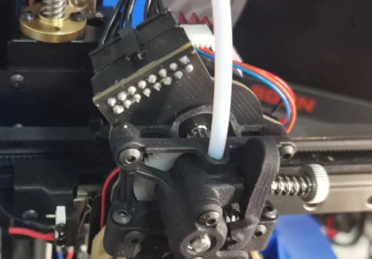

sherpa mini welding integrated board
The hub board suitable for sherpa mini extruder needs to use a thinned motor bracket to use MX3.0 and update two specifications of connectors---16P and 12P connectors. Personal printing of thinned connecting plates is difficult, so it is recommended to leave it to a third party such as 3D Bear. Please see attachment for printed document. Motor connector bit ph2.0
参考设计图片
