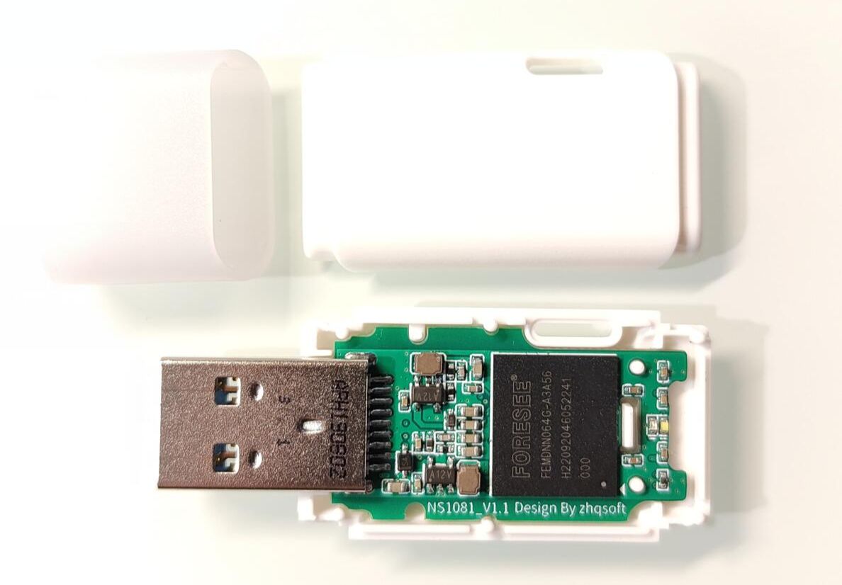

NS1081-USB3.0 USB flash drive main control board
There is no introduction, just a general solution, just talk about it.
In order to fit the shell, this solution only uses double-stick 153-ball EMMC.
Powered by 3.3v 1.8v independent DCDC.
Use a Toshiba shell that costs 2 yuan each on Taobao.
The speed is okay, but the power consumption is relatively large. The peak current is 300ma when writing at full speed with dual stickers.
I got a 128G U disk. There are too many EMMCs to use up.
