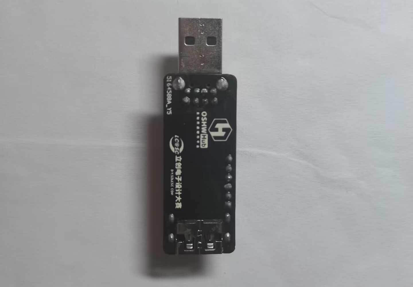

* 1. Project function introduction
A small and useful USB ammeter based on the national chip N32G430C8L7
* 2. Project attributes The schematic diagram of
the LiChuang training camp
refers to the official case, and the PCB is independently drawn
* 3. Open source agreement
Please fill in the competition stage↓
* 4. Hardware part The main
control circuit
needs to pay attention to each power pin of the chip needs to be connected to an additional 100nF external filter capacitor, and the 1st pin of the chip needs to be connected to an additional 4.7uf filter capacitor.
The power supply circuit
uses a typical ldo AMS1117. Although the maximum input of this model is 15v, considering the high temperature, it is recommended not to exceed 8v. If you need to measure a larger voltage, it is recommended to use a dcdc current sampling circuit
