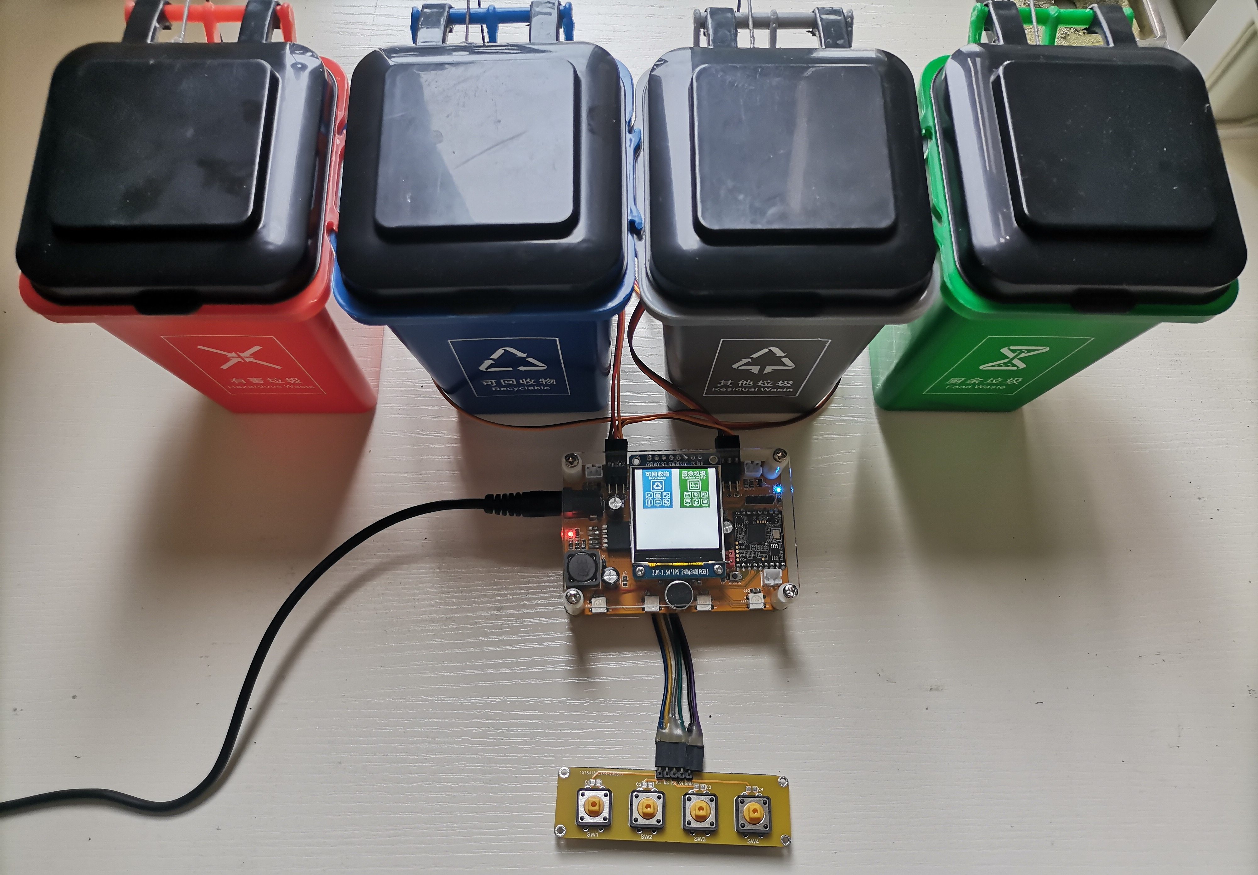

Introduction: Based on Wuhan Xinyuan Semiconductor CW32F030C8T6 and Qiying Tailun CI-C22GS02, the intelligent voice classification trash can can recognize voice to determine the type of garbage and open the corresponding trash can at the same time. It can be connected to ordinary buttons or touch buttons, or it can be connected to infrared proximity sensors to open the corresponding trash can.
Project Description
This design uses Wuhan Xinyuan Semiconductor's CW32F030C8T6 as the main control, which is mainly responsible for serial port communication with the offline voice module, responsible for outputting 4-way PWM signals, driving IPS display, controlling 2-way MOS drive circuits (controlling fans and lights), and driving 4 WS2812B lights. The voice recognition module uses the Qiying Tailun CI-C22GS02 module (the main chip uses Cl1122, which supports offline voice recognition of less than 200 local command words), which is mainly responsible for voice recognition and broadcast voice, and can communicate with the MCU through the serial port.

The intelligent voice classification trash can mainly includes the main control board, display screen, independent button module, trash can model with servo installed, and 12V power adapter.
