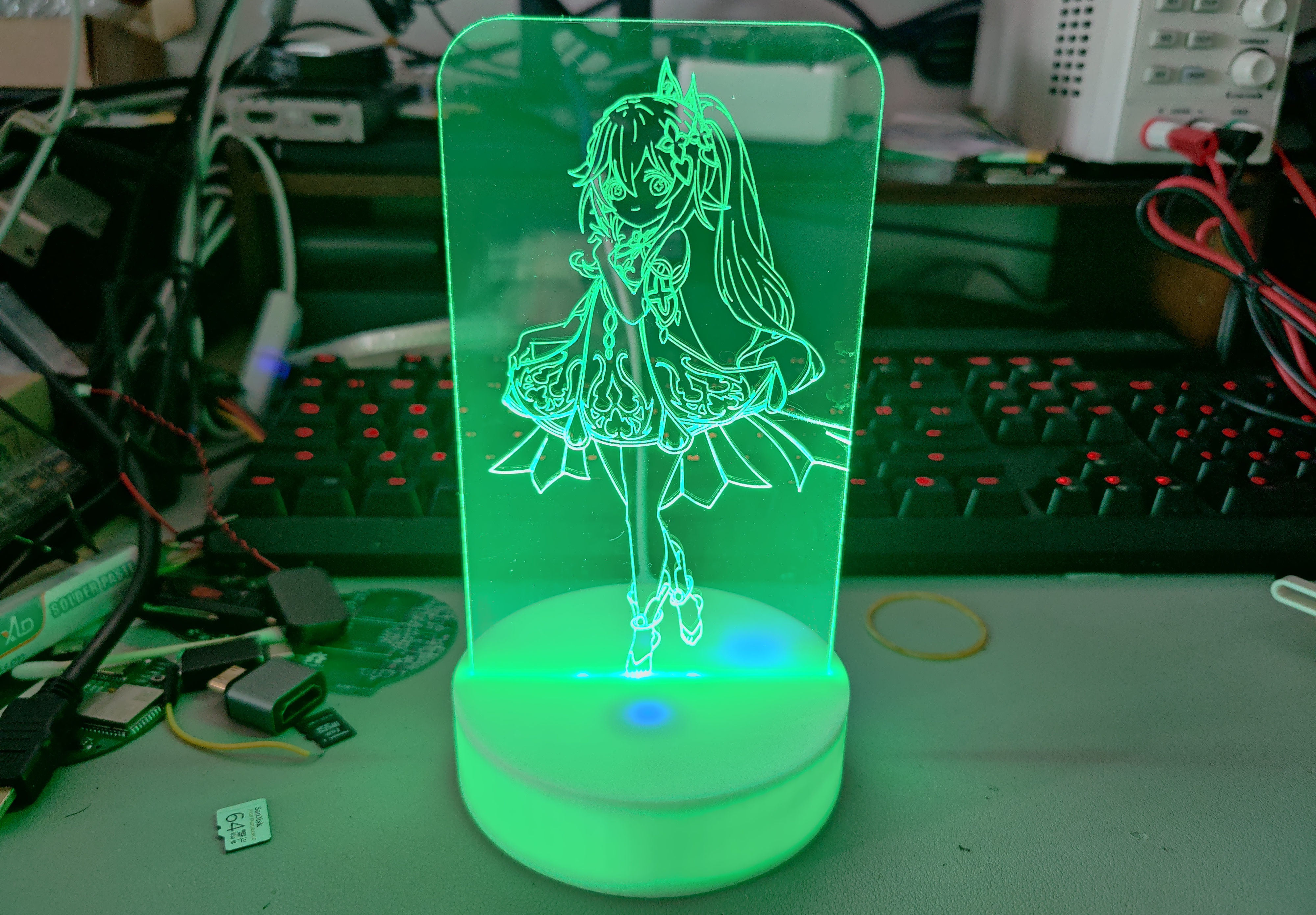

[Lichuang Panel Printing] Engraved stand-up night light
Main control: ESP8266
Lamp bead: 5050 WS2812B
firmware: WLED (https://kno.wled.ge)
M4*8 screw: https://detail.tmall.com/item.htm?id=627529370794 (Select M4* for specifications 8)
Touch switch: https://item.taobao.com/item.htm?id=666739298345
Panel printing instructions:
The AI ​​source file is provided in the attachment. There are two Nasida and one Keli.
Please use the attachment when printing the panel. When printing the panel from the "Keli-Nasida.ai" file,
please use the "Keli-Nasida.ai" file in the attachment.
When printing the panel, please use the "Keli-Nasida.ai" file in the attachment
to print the panel address. : https://dos.szlcsc.com/dos/panel/print.html?f=top
Be sure to note that engraving is required! ! !
3D printing instructions:
3D Monkey: https://www.sanweihou.com/
Select 3D printing, then unzip the shell model file in the attachment, then upload the two STL files inside, click Batch Edit
to select Resin-X Resin ( X resin may be free of charge)
PCB welding instructions:
When welding, solder the red wire to the red arrow, solder the yellow wire to the yellow arrow, and solder the black wire to the black arrow.
Firmware burning instructions:
Use TTL to connect the board
TTL RXD Connect the board TXD
TTL TXD connect the board RXD
TTL 3.3 Connect the board 3.3
TTL GND Connect the board GND
For the Chinese firmware, please refer to: https://www.bilibili.com/video/BV1t14y1h7f1/
The Android version is provided in the APP attachment, you can also go there yourself Google Play Store download
If you have conditions, you can go directly to the official website's online burning address for online burning
: https://install.wled.me/
If you have no conditions, you can download the firmware file in the attachment and unzip it, and open the ESP8266Flasher inside. exe
, select your serial port,
click the Config column, then click the small gear icon in the first line, select WLED_0.13.3_ESP8266.bin in the firmware folder,
select the Advanced column, select Baudrate 115200,
return to the Operation column, click the Flash button
at this time Press and hold the FLASH key on the board and then press the RST key to enter the download mode.
Wait for the progress bar to finish. After finishing, press the RST key on the board. The light should turn on.
Take out the phone, turn on wifi, and connect A wifi called WLED-AP, the password is wled1234.
After connecting, a webpage should automatically open for wifi configuration.
Select WIFI SETTINGS for wifi configuration.
If you don’t want to set up wifi, you can directly click TO THE CONTROLS below to directly control
and enter your home wifi name. and password, then click Save & Connect on the right side above to save the configuration.
At this time, you can see the IP address of WLED from the router management interface. Go to the address in the browser,
click Config,
click LED Preferences,
change the number of lamp beads to 12, and then click the bottom After opening the Save configuration
APP, click the + in the upper right corner. Add the device
to automatically search for the device. If the automatic search cannot be found, please add it manually. Enter the IP address of the device and click √ in the upper right corner to
install:
Use screws to fix the PCB on On the casing, just install the bottom cover. It should be noted that the screw holes must be completely aligned to be correct.
