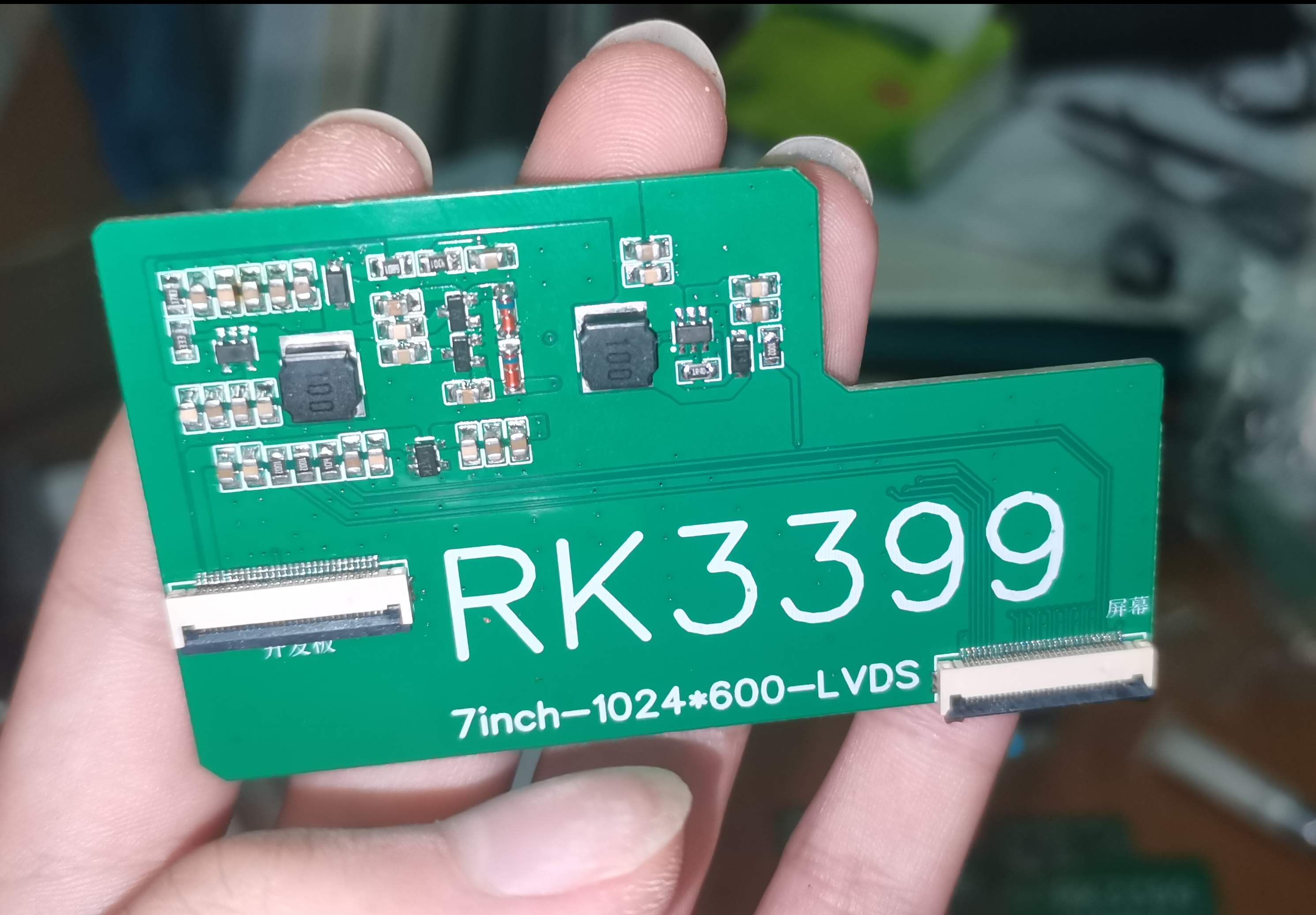

RK3399 screen adapter board (7-inch MIPI-1024*600)
The schematic diagram of this project refers to Rongpin RK3399 information. The adapter board has been printed and verified, and the display and brightness adjustment functions are normal.
The adapted screen interface is defined as follows:
Note: 1. The adapter board does not come with a touch screen, and the touch I2C interface is not drawn and needs to be modified by yourself.
            2. The FPC cables of the adapter board and development board must be reversed! The FPC cables of the adapter board and development board must be reversed! Connecting the front cable is equivalent to fully reverse connection.
             3. The recommended stacking sequence is JLC04161H-7628, impedance +-20%, and plate thickness 1.2mm.
             4. My drawing board level is limited, so everyone made a mistake.
