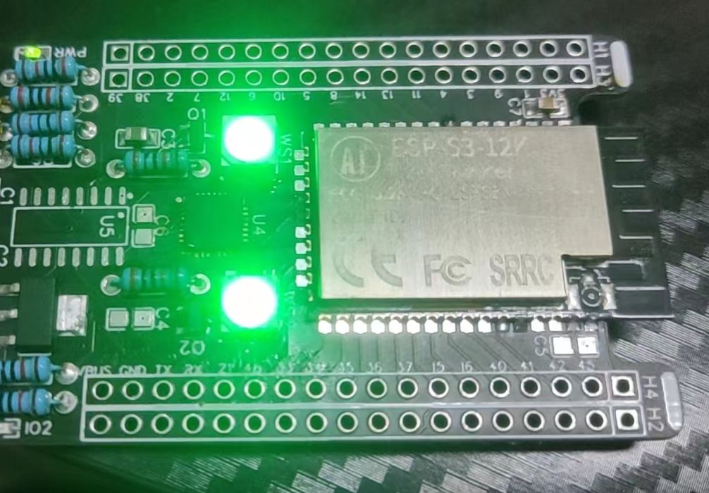

Thanks to @yyhc for the open source [ESP32-S3 core board](https://oshwhub.com/yyhc/esp32-s3-12k-hu-xin-ban), I just modified it based on it.
With **automatic download**, OTG, UART, two WS2812b, full IO dual pinout.
I also have a CP2102 and a lot of plug-in resistors I bought before, so the resistors are plug-in, all pull-up and pull-down, no voltage divider, resistance value 10k - 820k is fine. I put a 20k LED, you can see that it is not very bright. ,len:
0x403b6138 ESP -ROM:esp32s3-20210327 Build:Mar 27 2021 rst:0x1 (POWERON),boot:0x8 (SPI_FAST_FLASH_BOOT) SPIWP:0xee mode:DIO, clock div:1 load:0x3fcd0108,len:0x404 load:0x403b6000,len:0x6ec load:0x403ba000,len:0x26b4 entry 0x403b6138 ESP-ROM:esp32s3-20210327 Build : Mar 27 2021 rst : 0x1 ( POWERON ) , boot:0x8 (SPI_FAST_FLASH_BOOT) SPIWP:0xee mode:DIO, clock div:1 load:0x3fcd0108,len:0x404 load:0x403b6000,len:0x6ec load:0x403ba000,len:0x26b4 entry 0x403b6138 #################### ####################### arch:ESP32S3,0 company:Ai-Thinker|B&T wifi_mac:F412FA43**** ble_mac:F412FA43**** sdk_version:v4.4-dev-3042-g220590d599-dirty firmware_version:1.0.1 compile_time:Feb 8 2022 14:34:08 ready ###################################################### ``` ![ESP32 S3 12k.jpg] My welding skills are average, please forgive me * * * The project is developed using IDF4.4, and the RGB lamp is successfully lit using the `ESP32-NeoPixel-WS2812-RMT` library.
