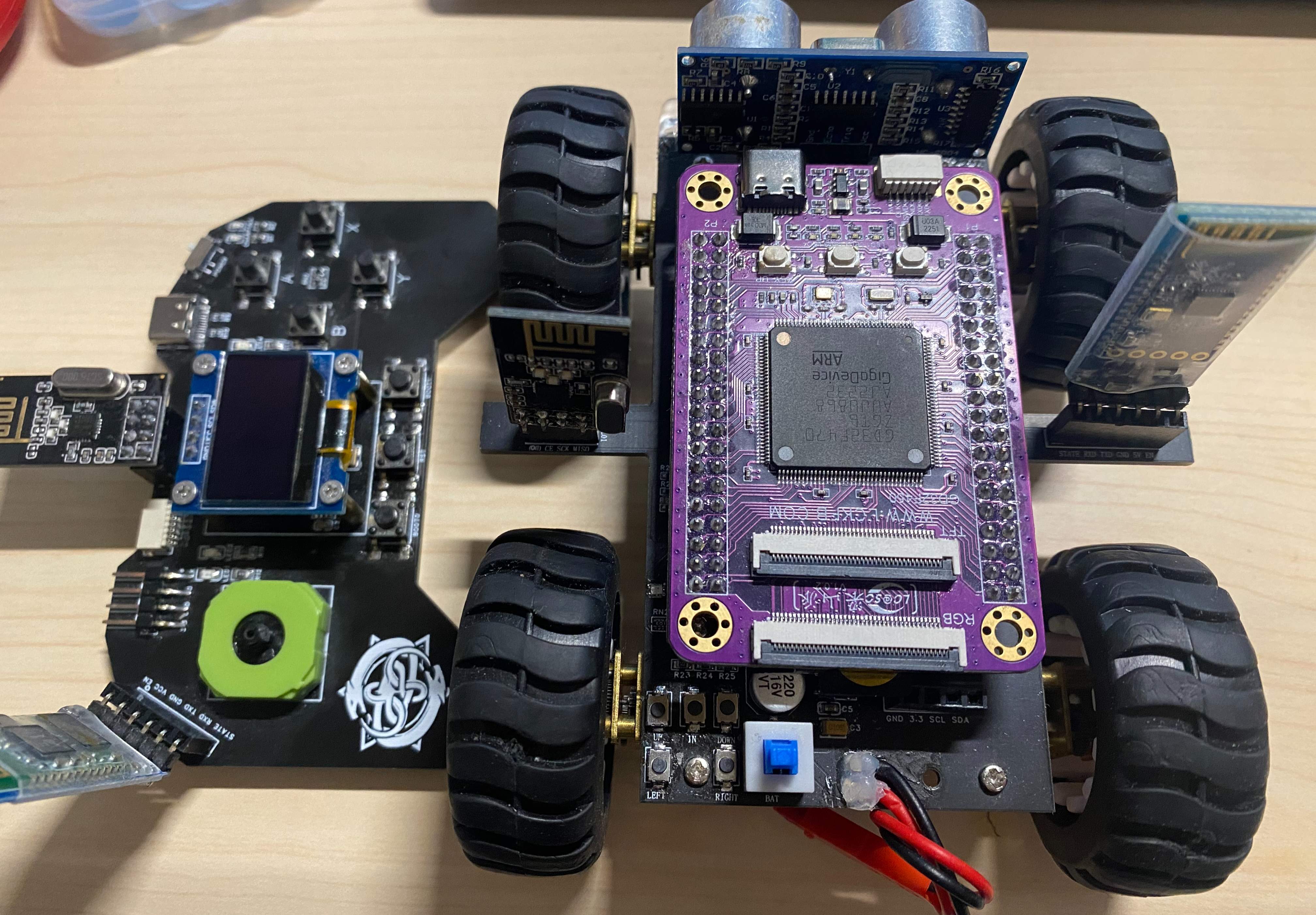

#### **Description** This
is the hardware and software design of the initial version of the car and remote control. There is still a lot of room for improvement in the hardware part, and there are still many functions that have not been implemented in the software code. Currently, only the wireless remote control and some basic device driver codes have been written. There is still a lot to be improved. You are welcome to criticize and correct me!
The codes and demonstration videos of the car and remote control are given in the attachment (the comments are encoded in UTF8)
#### **Actual pictures**
![DD46026D48809AB59E0BAFBEE44AE720.png] ![F9192333C72F04BAD025D44D6791A2AC.png] ![418C14A214B7805FAB58B6A4AE4EA4FF.png] ![93EF164699441AD21E78A811E422DC4B.png] ![11.png] ![11 (2).png] #### **Hardware part**

(1) The car and the car remote control are designed with buttons, display interfaces, and LED lights to facilitate the expansion of functions according to needs.
(2) The car and the car remote control are designed with NRF24L01 interface and HC-05 interface to facilitate the realization of 2.4G remote control and Bluetooth remote control functions.
(3) The remote controller is equipped with a rocker potentiometer (left over from the last game console training camp, haha, making full use of it), which can be used to control the movement of the car very smoothly (see the demonstration video).
(4) The car is equipped with an ultrasonic sensor and a 3mm LED, which can realize obstacle avoidance and night lighting.
(5) The remote controller is integrated with the Liangshan School DAPLINK download port, so there is no need for multiple downloaders. One downloader can complete the download and debugging of the car + remote controller.
