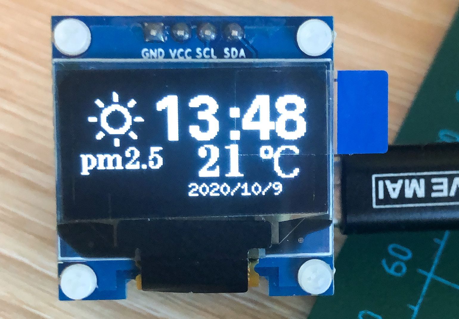

Then I’ll send you a preview of the actual product :)

1. When welding the TYPEC port, do not let too much tin come out from the back of the fixed post. If too much tin comes out, there may be a risk of short circuit with the components on the back. Although I have deleted the GND network of the fixed post, everyone still needs to be careful. Better;
2. The size of 0.96 OLED is as shown below. The fake Baoyouxinjia sells finished OLED modules;
3. The screen and motherboard are fixed using 2mm screw holes and bracket posts. After all, the motherboard is too small and the 3mm screw holes are too big~

Finally, I attach the actual demonstration renderings. I will not demonstrate the burning process. They are all automatic burning procedures. Anyone who plays 8266 will understand:)
