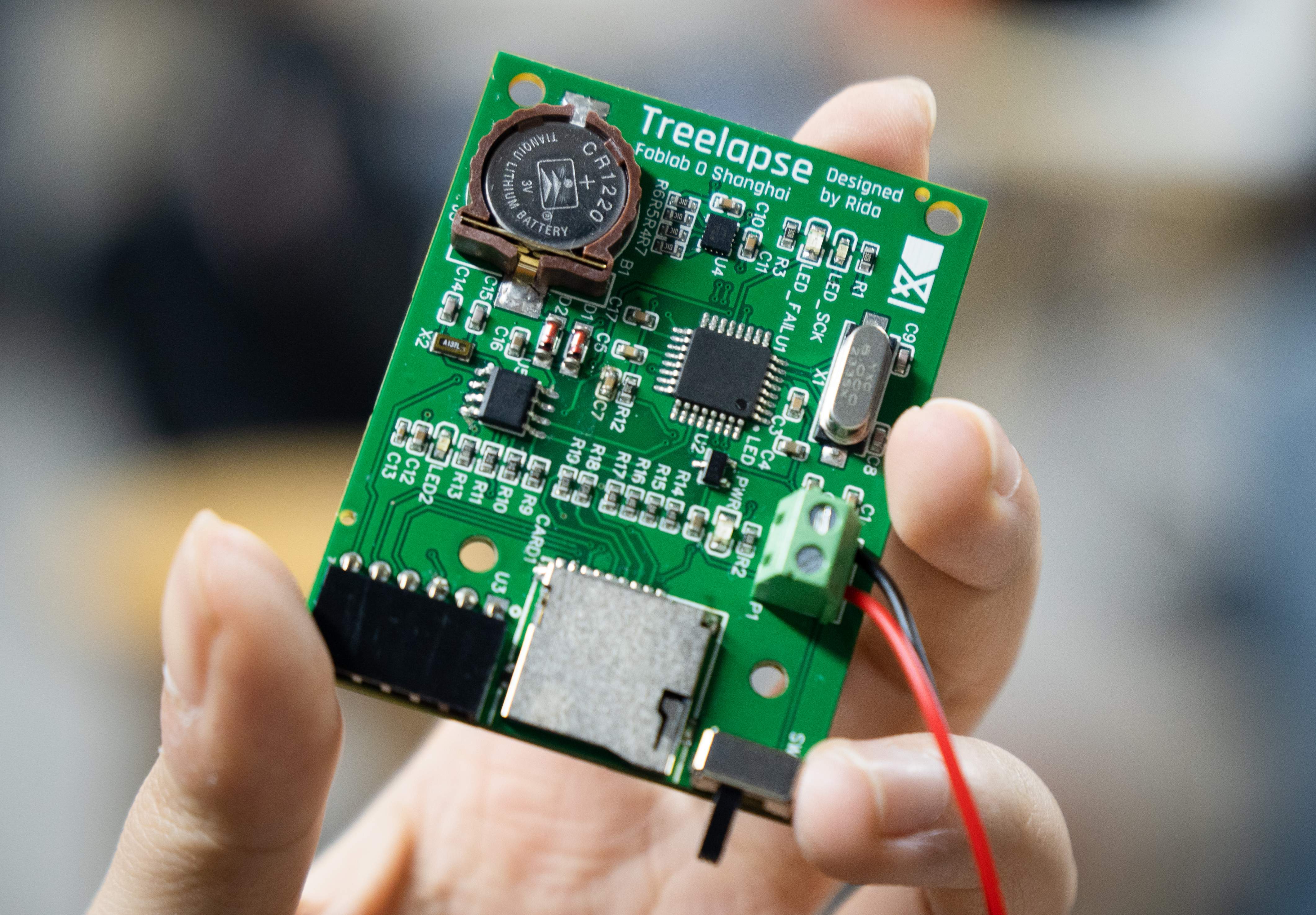

***Treelapse*** is a device that can record the movement of a tree. It can be strapped to a tree and the gyroscope and accelerometer inside will detect and record the movement of the tree. The data generated will be saved into a log file on the TF card. Then the user can remove the TF card and use the log file to generate a digital art that use an algrithm strongly connected to time and the data collected.

### PCB Design
- **Processor:* * ATmega328P-AU
- **Gyroscope & Accelerometer:** BMI-160
- **Clock:** Pcf8563
- **Storage:** TF card
- **Battery:** 9V battery
Schematics:
![pcb_sch.png]
Top:
![pcb_top.png]
Bottom:
![pcb_bottom.png]
3D preview:
![pcb_3d_preview.png]
Final result:
![_DSC6095.jpg]
