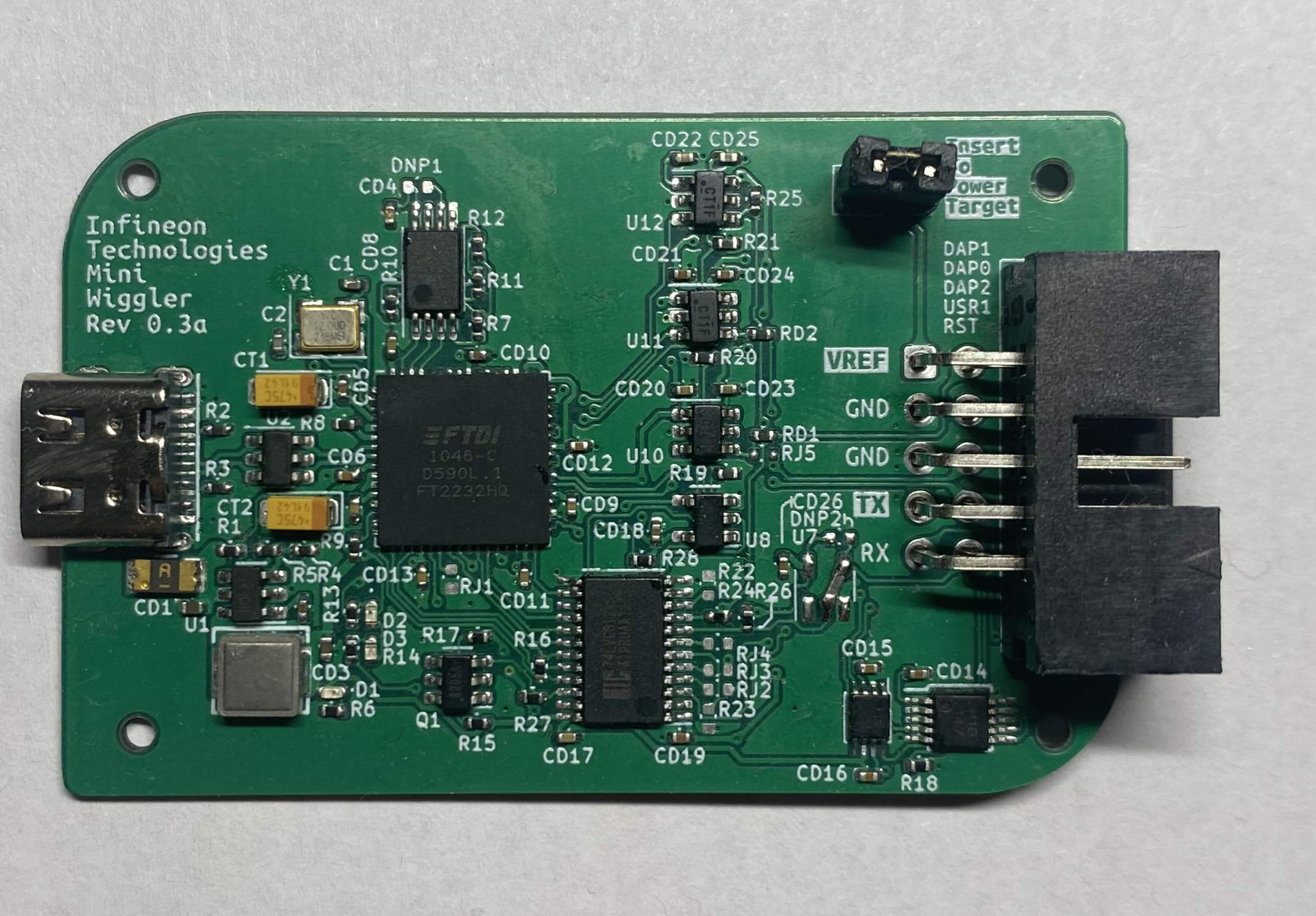

* This project is **drawn** with KiCad, so **there is **no** free lceda unconditional board making. **The schematic preview is at the bottom**, please pay attention. **The following version is imported, please use gerber to make the board directly**.
* There is a **problem** with the Reset circuit part of this project, **please use it with caution**, the Gerber below has modified the flying wire on the board, the original design has a diode or OD gate responsible for reset, I directly connected it to 74LVCH8T245 :( It may burn the board
* Direct connection of Reset will cause the Reset button on the core board to fail, maybe it will be fixed in the next version, but I don't know how to fix it :(
* **Please read the welding guide carefully**
