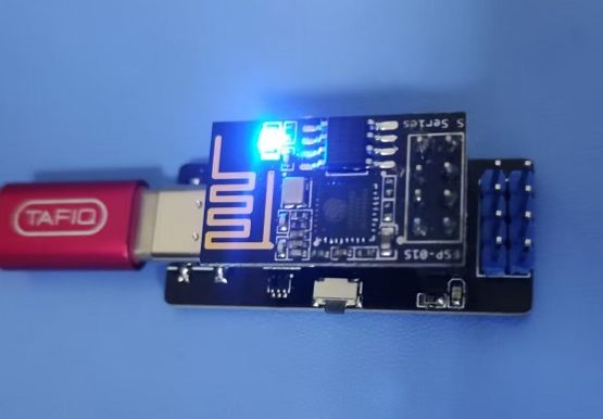

![Package picture.png] #### Automatic download circuit
NMOS model: https://item.szlcsc.com/63955.html The reason for using this is to clear the inventory, and it can be replaced with other models and can be used as well.
![Snipaste_2023-04-06_20-27-49.png] #### Test program
```c
#define led 2
void setup() {
pinMode(led, OUTPUT);
void loop() {
digitalWrite(led, HIGH);
delay(1000);
digitalWrite(led, LOW);
delay(1000);
#### Actual picture
![2.png] ![1.png]
