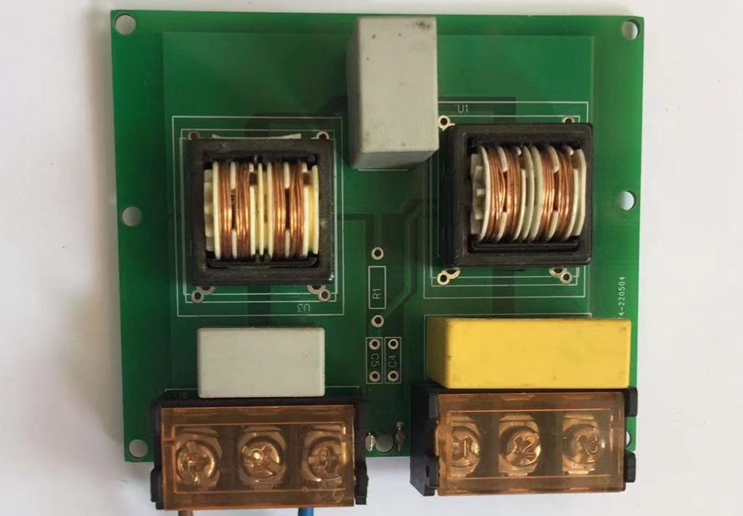

EMI filter
This has been tested and verified, you can use it with confidence! ! !
Notes: 1. This product involves 220V mains power, minors are not allowed to operate it! ! ! Open source personnel will not be responsible for any harm caused to users! ! !
2. The ultimate withstand voltage of this product is the maximum withstand voltage of the capacitor, and the maximum current is the maximum current of the common mode inductor!
3. This product is suitable for mains power, not for low-voltage DC!
use:
Mains power has a lot of clutter, impact, and surges, which may cause certain damage and instability to electrical appliances. This EMI filter can make the mains power more stable.
Installing it on a switching power supply can extend the life, it is true!
Installing it on the speaker can reduce the impact on the speaker!
Note: The common mode inductor in the circuit diagram supports the following models: SQ1010 horizontal, SQ1212 vertical, SQ1515 horizontal, SQ1918 horizontal, SQ1918 vertical, SQ2418 horizontal, SQ2820 horizontal
