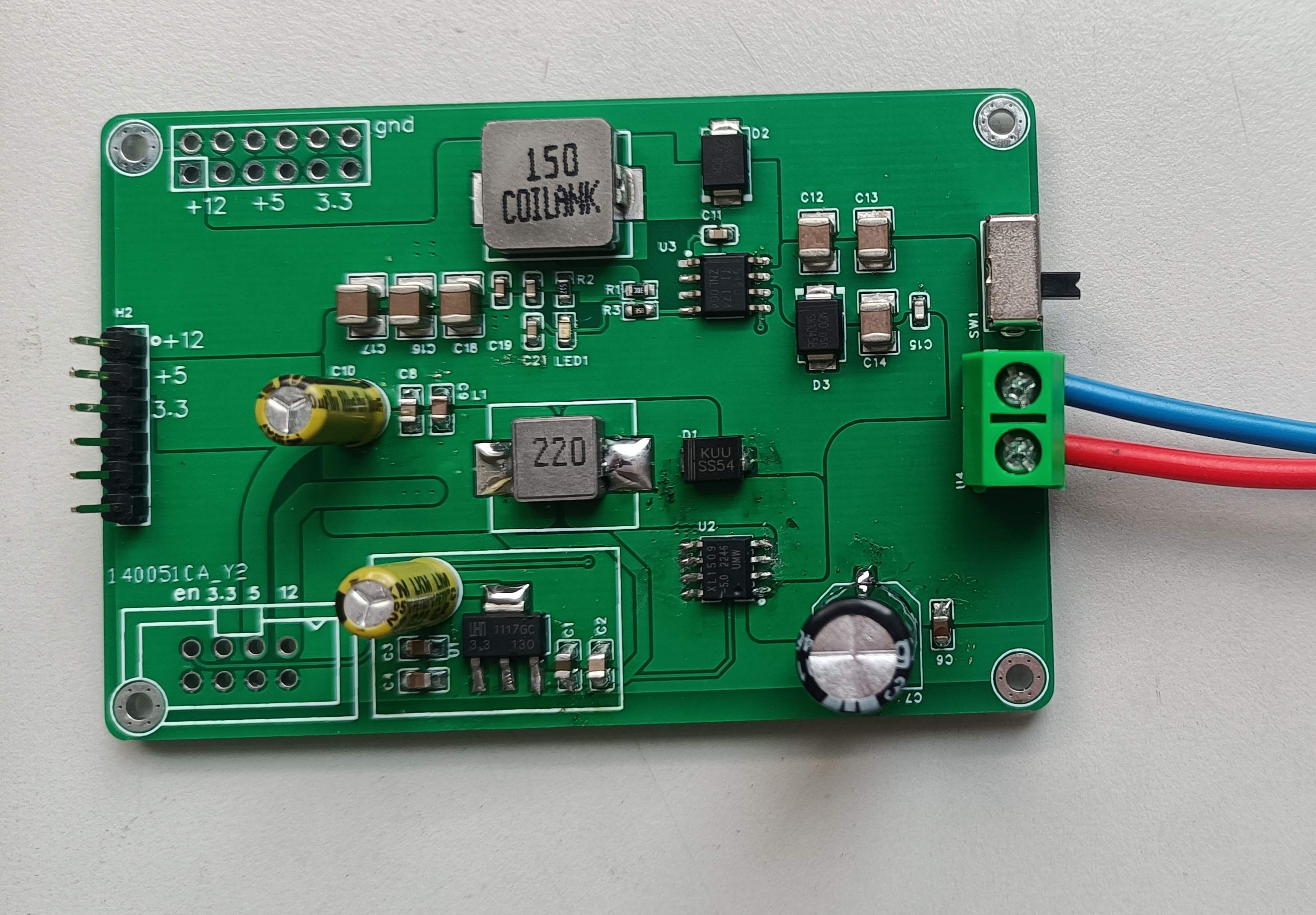

1. The auxiliary power supply part
inputs 25-30V DC and can output 12V, 5V, and 3.3V DC.
Among them, 12V uses TI's TPS5450DDAR, adjustable input voltage: 5.5V~36V, output voltage: 1.221V~31.32V, output current (maximum value): 5A TPS5450 5.5V to 36V input, 5A, 500kHz buck converter.
5V uses XL1509-5, and the input range is 4.5-40V. The maximum output current is 3A.
Among them, the efficiency of 12V at 1A output is 85%.
