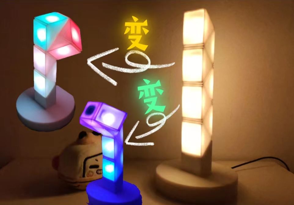

Finished product effect display:
B station video: [DIY] Thirty-six changes? Come and create your own unique desk lamp~ Modular colored lamp display
picture effect:
Idea conception:
(1) Source of inspiration
(2) Design sketch
(3) Final design

Finished effect:
The modules of the colored lights can be freely combined and deformed. After the controller is powered, the lights can be controlled through the mobile phone app.
