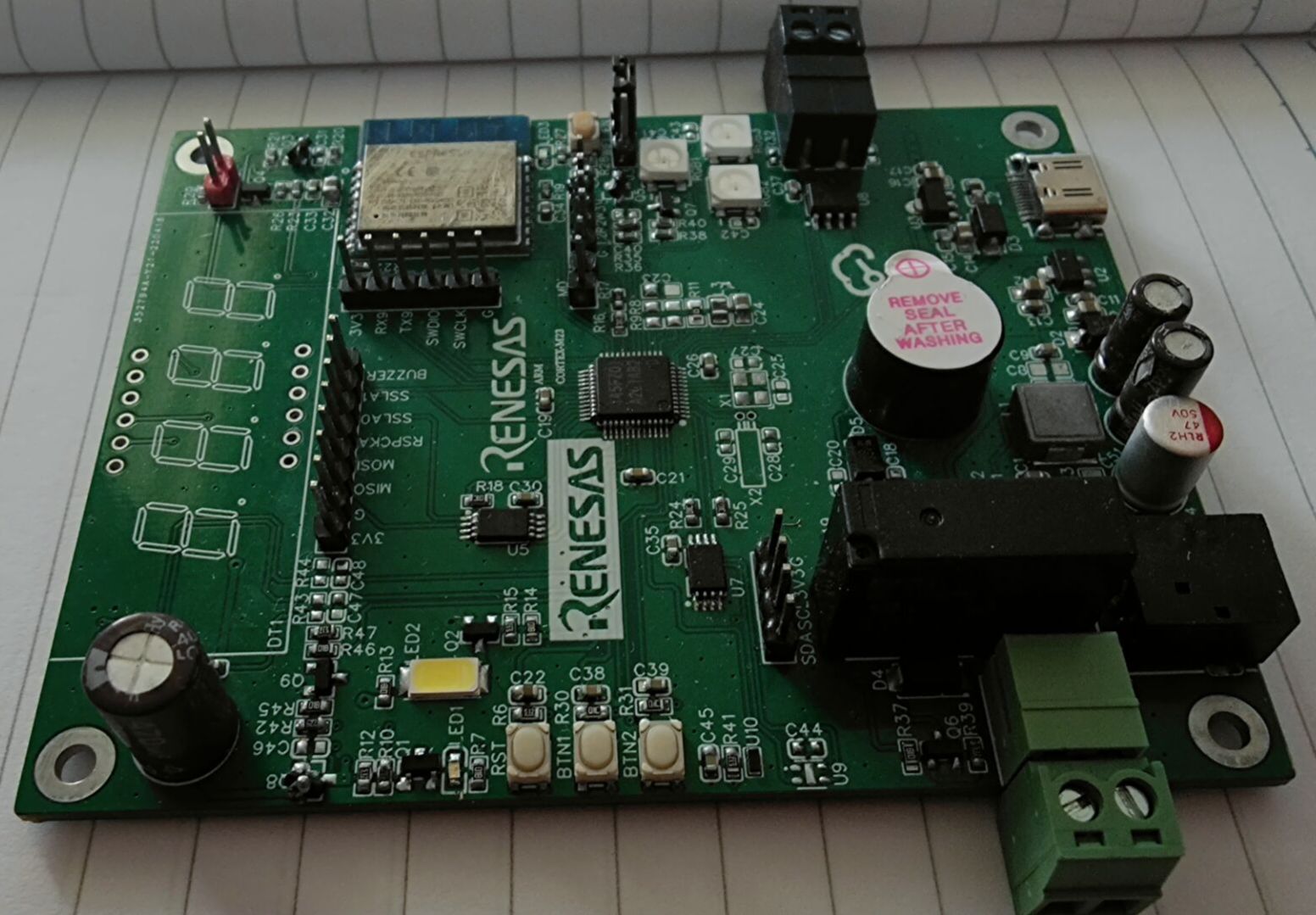

4.17 Place the pcb order, the 3D rendering is like this QQ picture 20220509163324.png4.21 Received 2pcs of chips, the price of each piece is 26.16! I picked up a pen by the way ( QQ picture 20220509163948.png4.24 I received pcb 6pcs (a small surprise) QQ picture 20220509164337.png4.26 The entire board welding was completed (almost - "disappeared digital tube") QQ picture 20220509165044.jpgthe amazing vertical welding (PMOS was drawn wrong x3) QQ picture 20220509165127.png4.27 Turn on the light and burn it once √

5.2 The irreparable bug finally came.
SHTC3 could not work normally. After a few days of tossing,
the reason was: guessing that the wire pull was unreasonable and the sensor chip was good.
The result: remove it, leave it blank, and wait for the v0.2 version. wifi
module√
buzzer√
led​​​​ ​No problem. After the software is perfected, the pcb v0.2 version will be updated.
